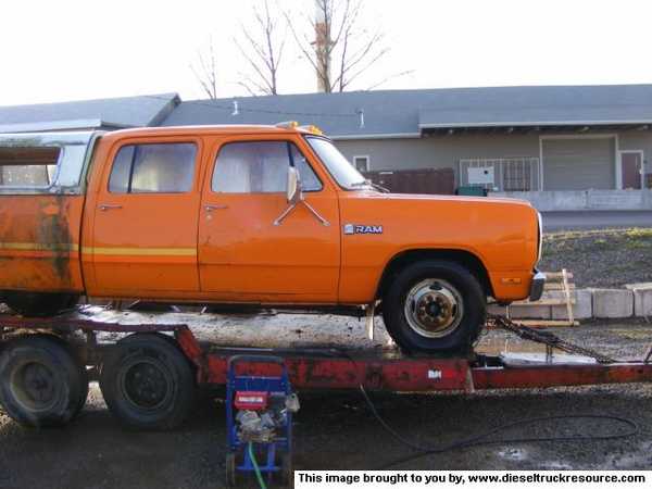

what the cab looks like

Sounds like a good project, but if you weren't going to 4x4 I'd stay with the dodge crewcab chassis. Inspect it when you get the chassis off, it is very beefy

the fun part is the frame strech ford is standard cab and the dodge is well alot longer. but i have a cnc plasma and torch so the fish plates will be easy.
