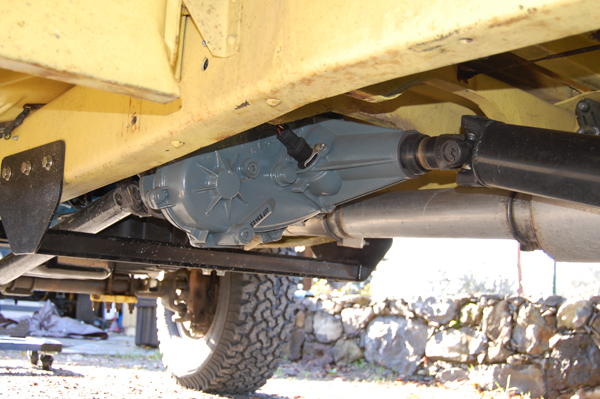

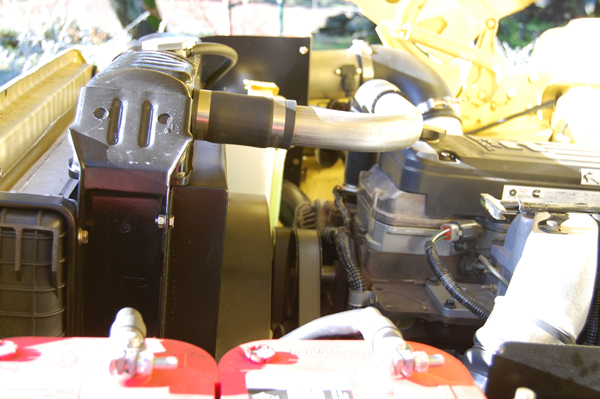

Here are a few pictures - I hope.
I set the TC lockup to 50 mph and that seemed to help the shifting - but it hits almost at the same time as the shift to fourth - still needs some work. The TC lockup is really harsh. I see people using the option to use partial throttle tables, but I can't figure out how to make that work.
Peter
Attached Thumbnails 2005 HPCR in '68 Ford-dsc_0008.jpg   2005 HPCR in '68 Ford-dsc_0010.jpg

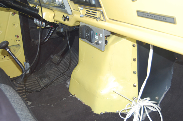

and more pictures
