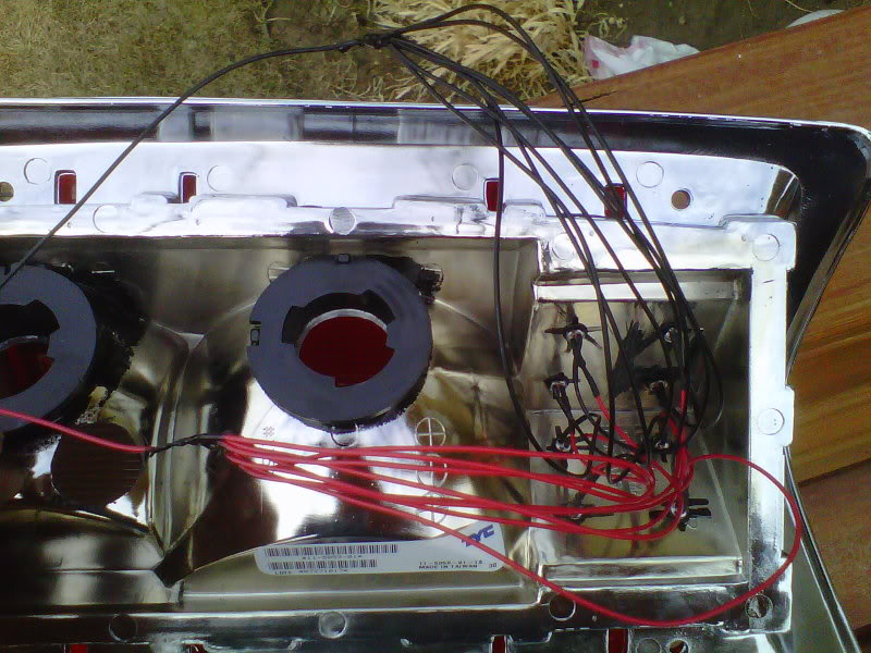

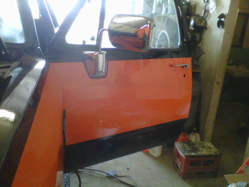

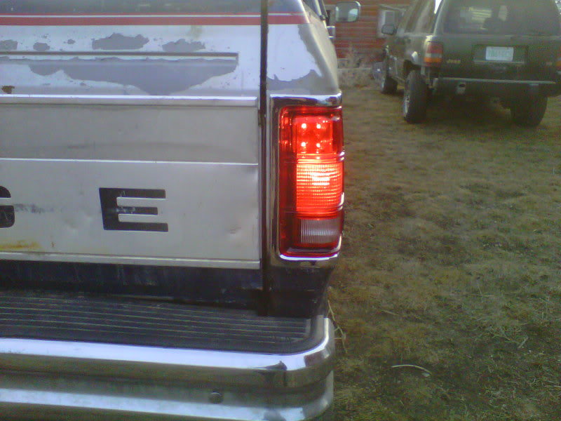

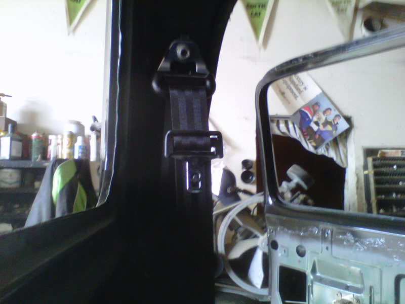

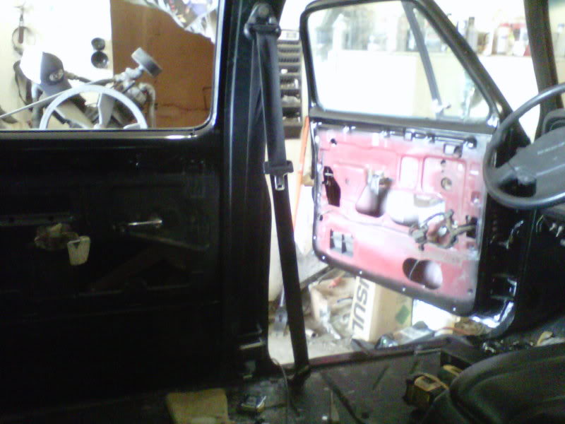

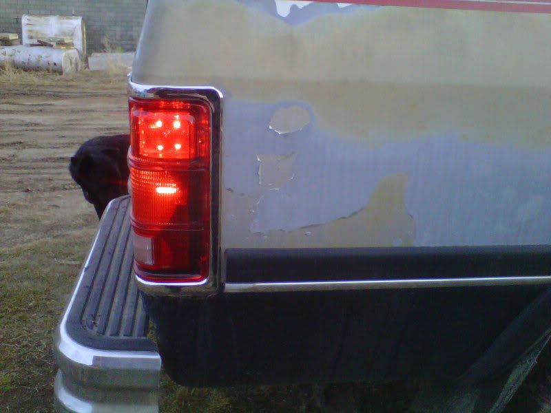

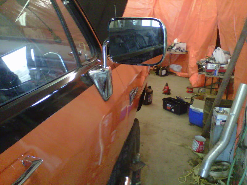

Modified the tail lights with some additional led lights, installed the new power mirrors and was able to get all the Ford seat belt hardware to work!

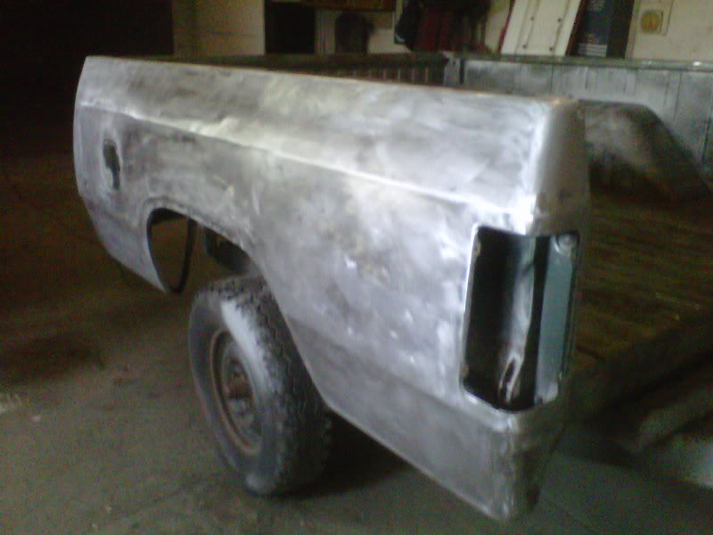

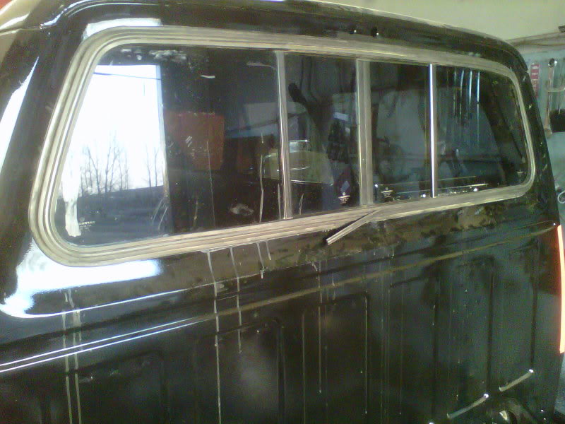

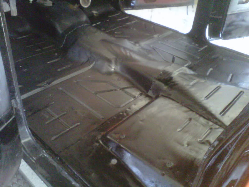

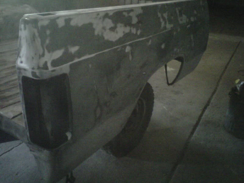

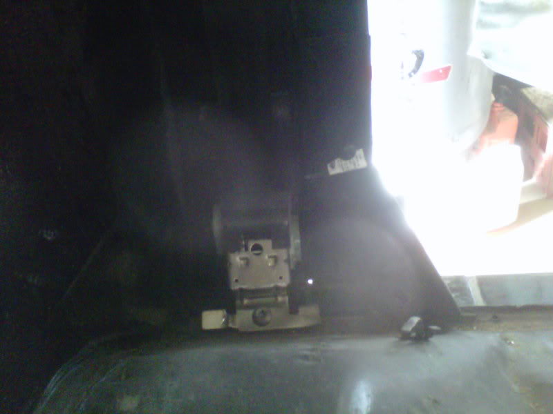

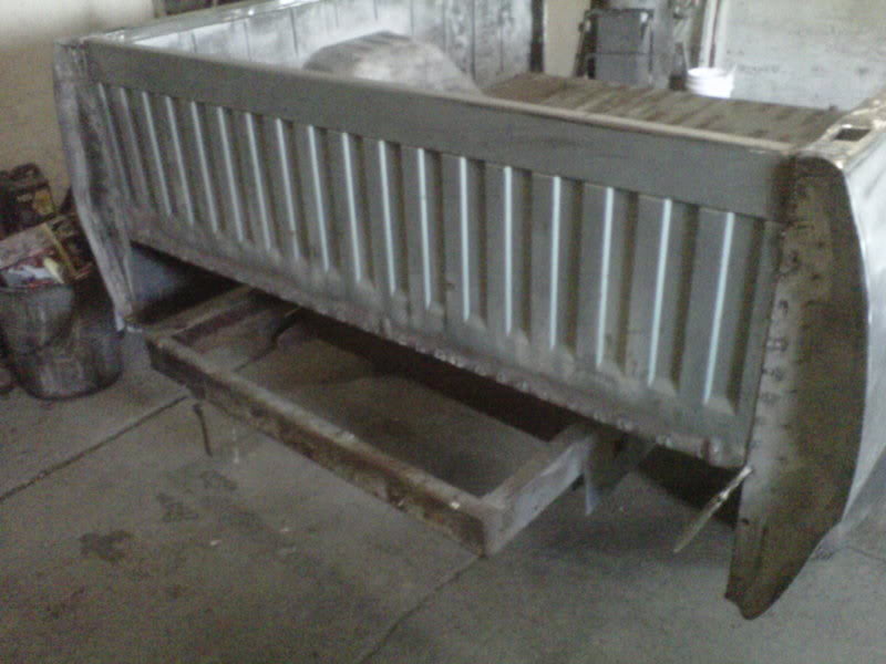

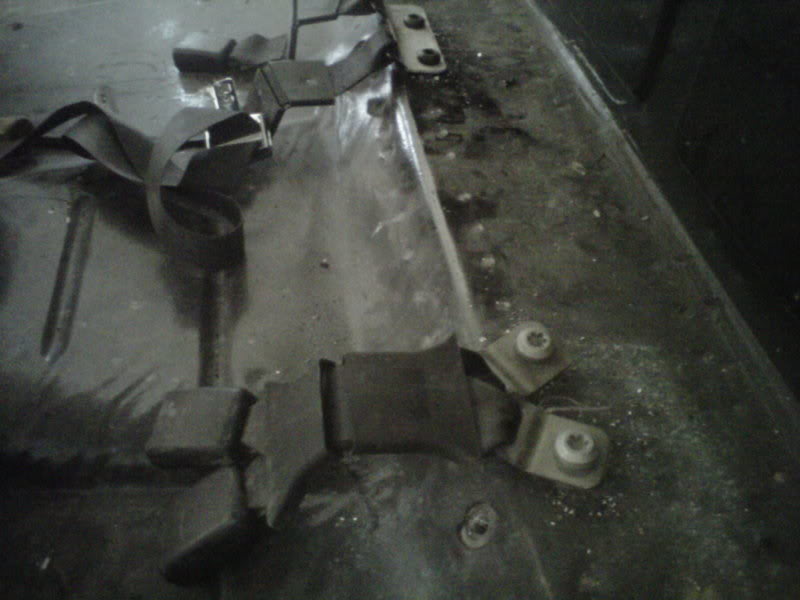

The box is coming along nicely, rear window in. Frame under cab and cab floor sanded and rust checked, ready for undercoating. All the original seat holes are welded shut as well as the seat belt holes I won't be using and then coated with a sound treatment

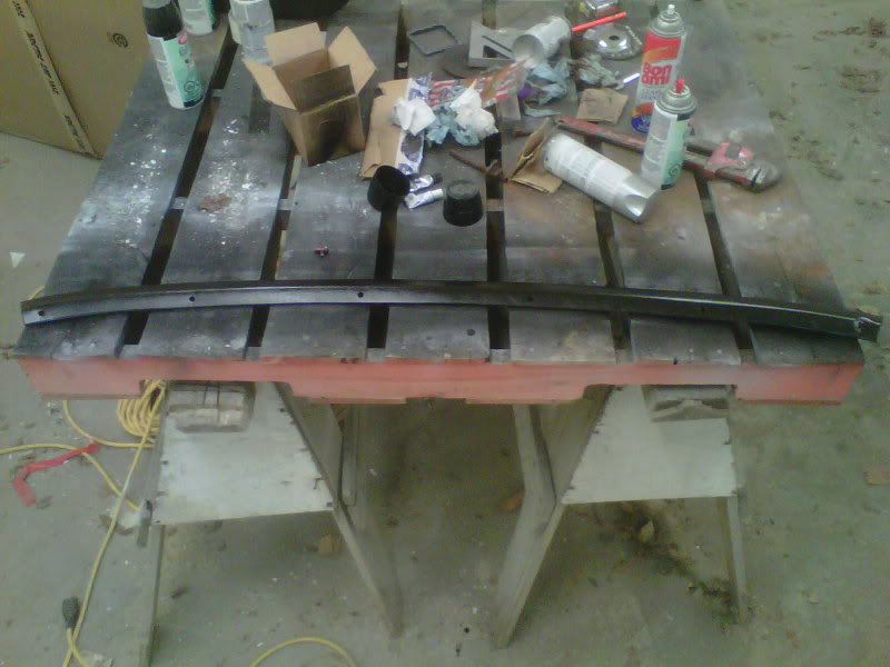

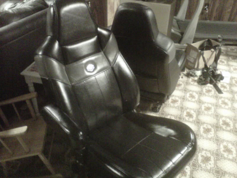

Been working on cleaning up the seats in the basement last couple of nights, should finish tomorrow. Look at the difference on the back one!! Also repaired a over the windshield moulding and painted it.
