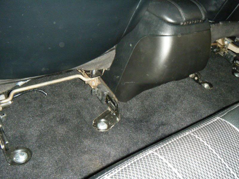

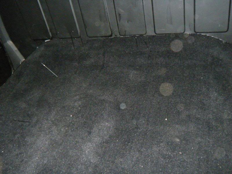

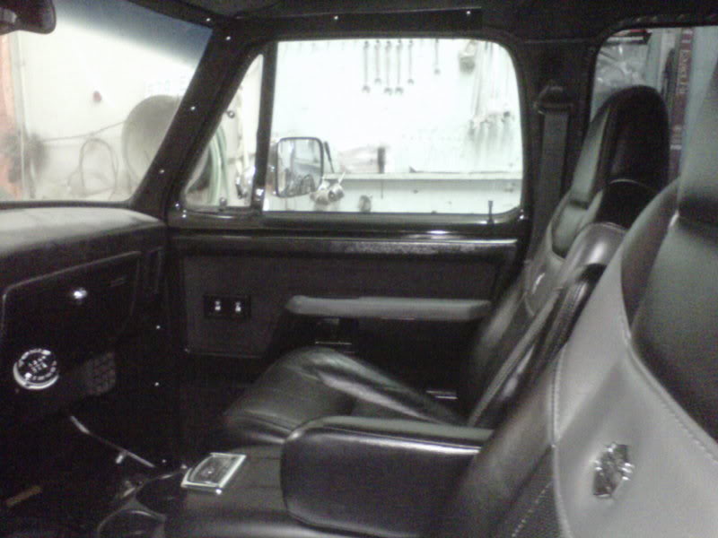

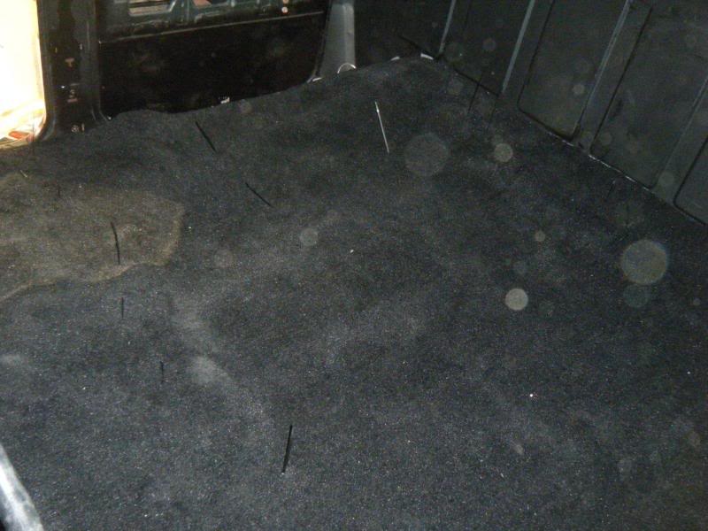

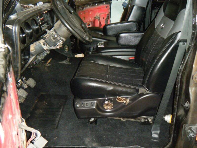

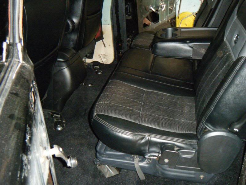

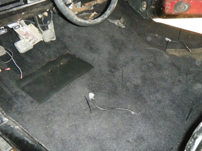

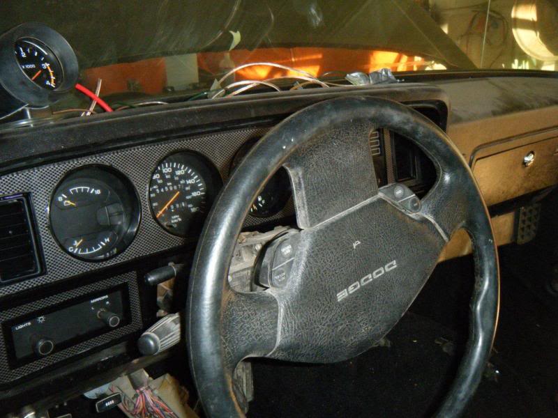

Installed the ACC carpet, seats and started on the seatbelts. Rear glass tinted and installed, all door locks and pins installed and keyed alike, glove box installed, all gauge wiring ran, air compressor and controls installed.

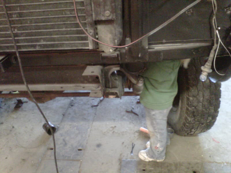

My helper inspecting the compressor mounts

Where did you get the carpets, who is ACC?

You've been very busy!!! That interior is looking really nice!!

Bought the carpet from stockinteriors.com . ACC stands for Auto Custom Carpet
Thank you! I need to work hard to stay ahead of you!! If I don't watch my back you'll be driving yours and I'll still be looking at mine in the shop.
I'm very happy with the way the interior came together, it all looks like it belongs. Excited to get the door panels on now!

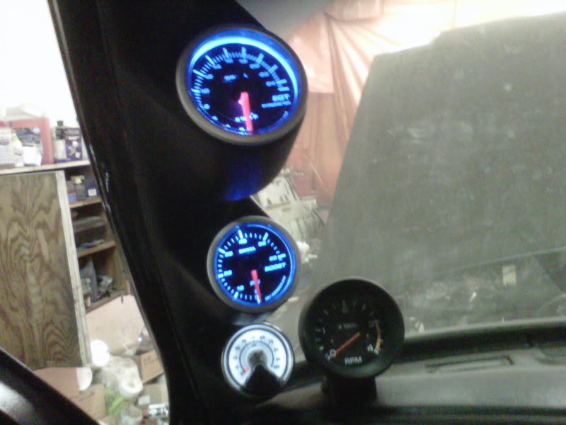

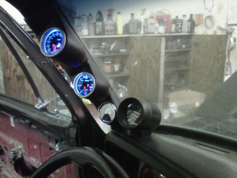

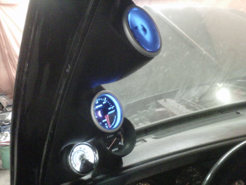

Havent got much done this weekend, got the pillar pods installed and gauges but of course the Airlift gauge leaks :mad

Gauges look good man.

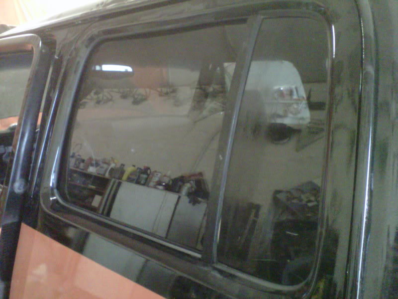

Where you able to find new rubber for the small pc of glass that goes on the rear doors? If so do you mind sharing your source?

Thank you, sorry I don't know of any source for those rubbers. Thankfully mine are in good re-useable shape.

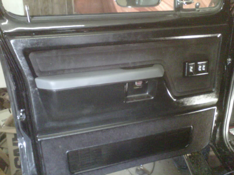

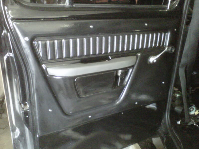

Door panel and plastic trim install

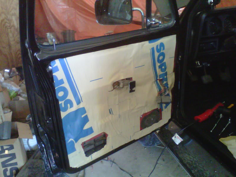

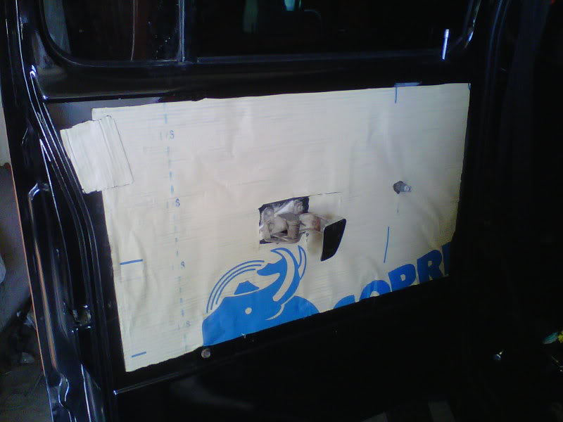

Whats the tyvek like stuff you used to seal up the door instead of plastic?

I think mine are too, but if I could buy new ones I would do that instead of re using the old ones. I will keep looking, I won't probably start putting the doors back together for another month, still need to order all the felt, rubber, etc. for the rear doors and try to find new latches if I can.

Its sopraseal, its a tyvek like material over SBS modified bitumen, similar to dynamat and the others. Just not as good but I got a roll free so.... Also did the door panels and everywhere else I could.

I agree, would liked to have found new ones but had no luck. Please let me know if you find some.

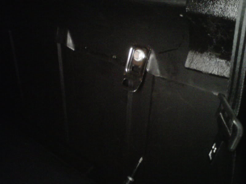

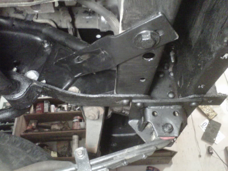

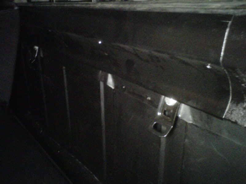

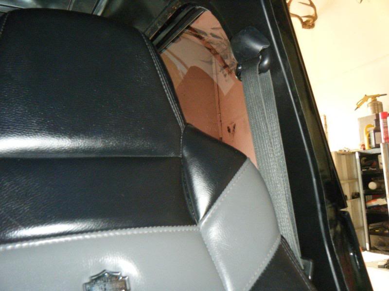

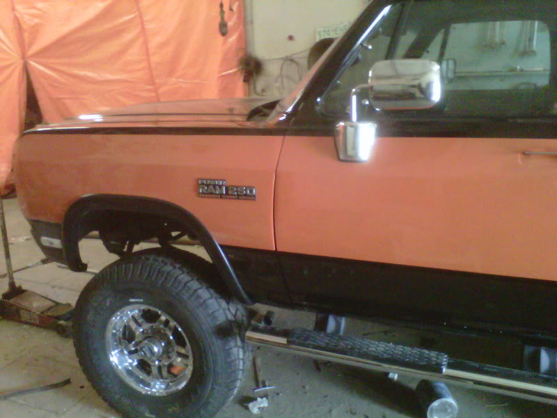

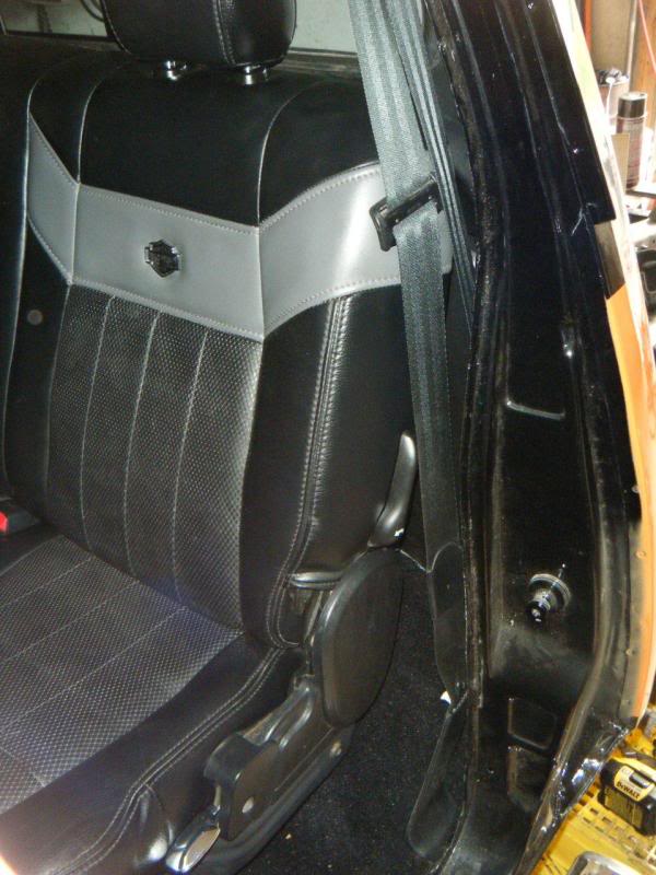

Tires and wheels on, child seat anchors fabbed and installed and ramcharger steering brace installed.

Everything looks great!!! I bet you are getting excited to drive it down the road!!
Where did you source your new seat belts from or what vehicle? I need new ones and want black ones as well.

All the belts are from a 06 F350 and are modified to fit

They are fairly close and bolt on similar, biggest difference on the front is adding the additional anchor point and cutting a few slots in the b pillar. The best part is that they work with the seats! If you want or need additional pics/info let me know.
