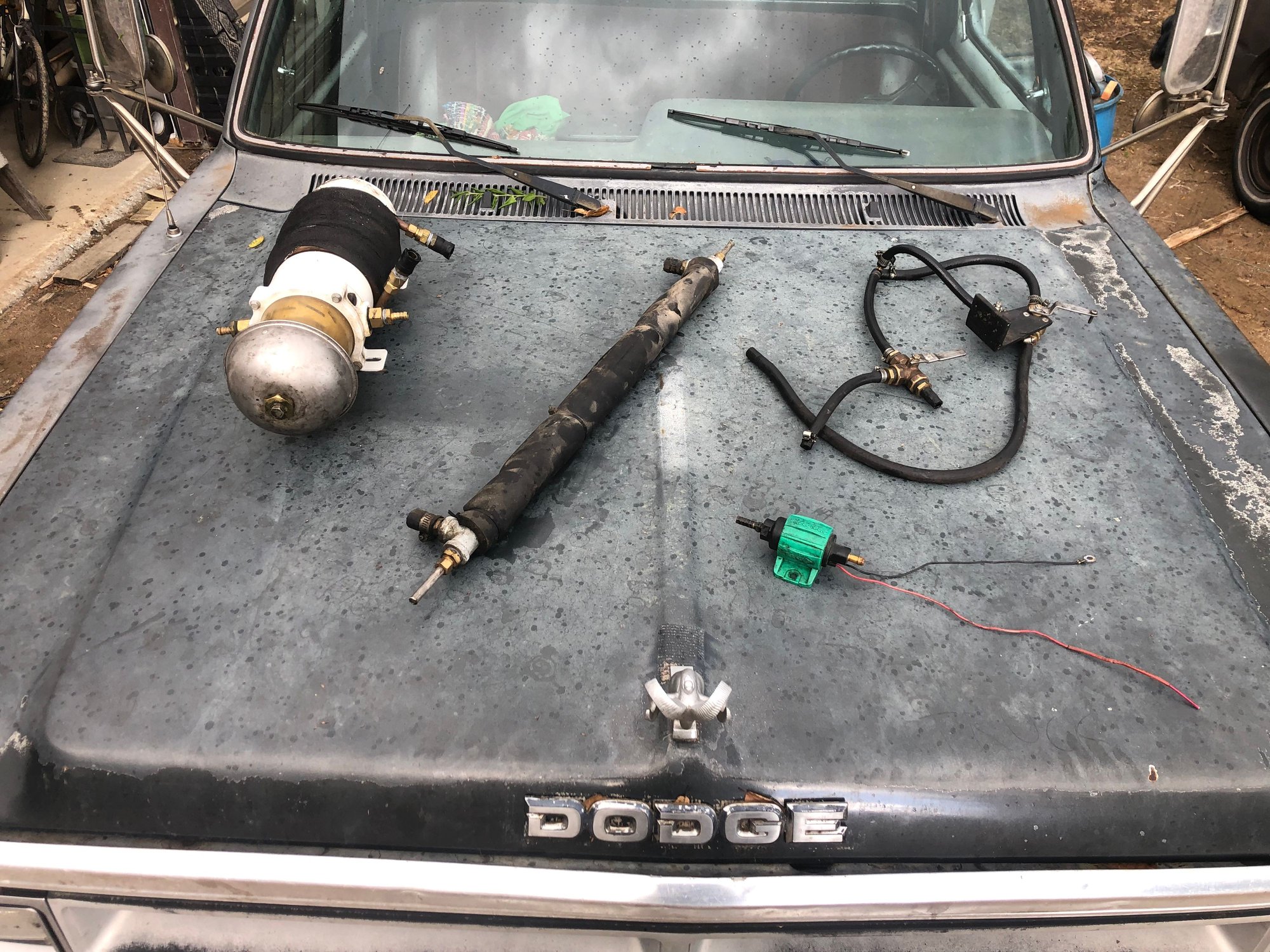

As for the donor dodge, it’s a 1990 non-intercooled d250. The engine is clean and stock at 450k. Cab is dented and noisy, and everything inside is failing plastic. Want to delete. CA valley truck with no rust on the frame. I built a WVO system in it last summer and drove it across the country for next to nothing when diesel here in California was $7/gal. Planning on rebuilding the fuel system a third time during the cab swap.
Key components of the WVO system pulled.
