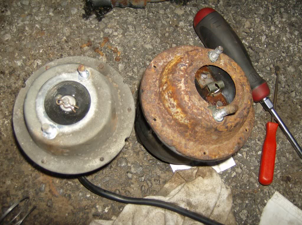

Gas on left with cotter-pin, diesel on right with maze hook

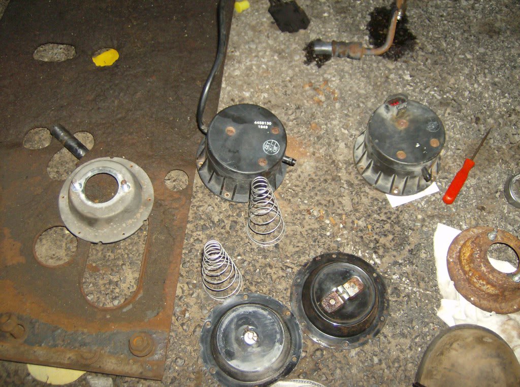

I took both units apart, and laid all parts out in front of where i was sitting.
Be careful with the screws, they strip very easily. I had to take a pick to get the rust out of the screw holes on the one.

This is the one we want for our trucks, cleaned up real nice with WD-40

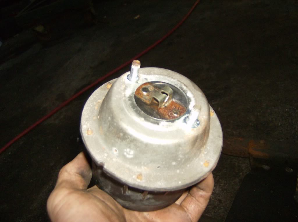

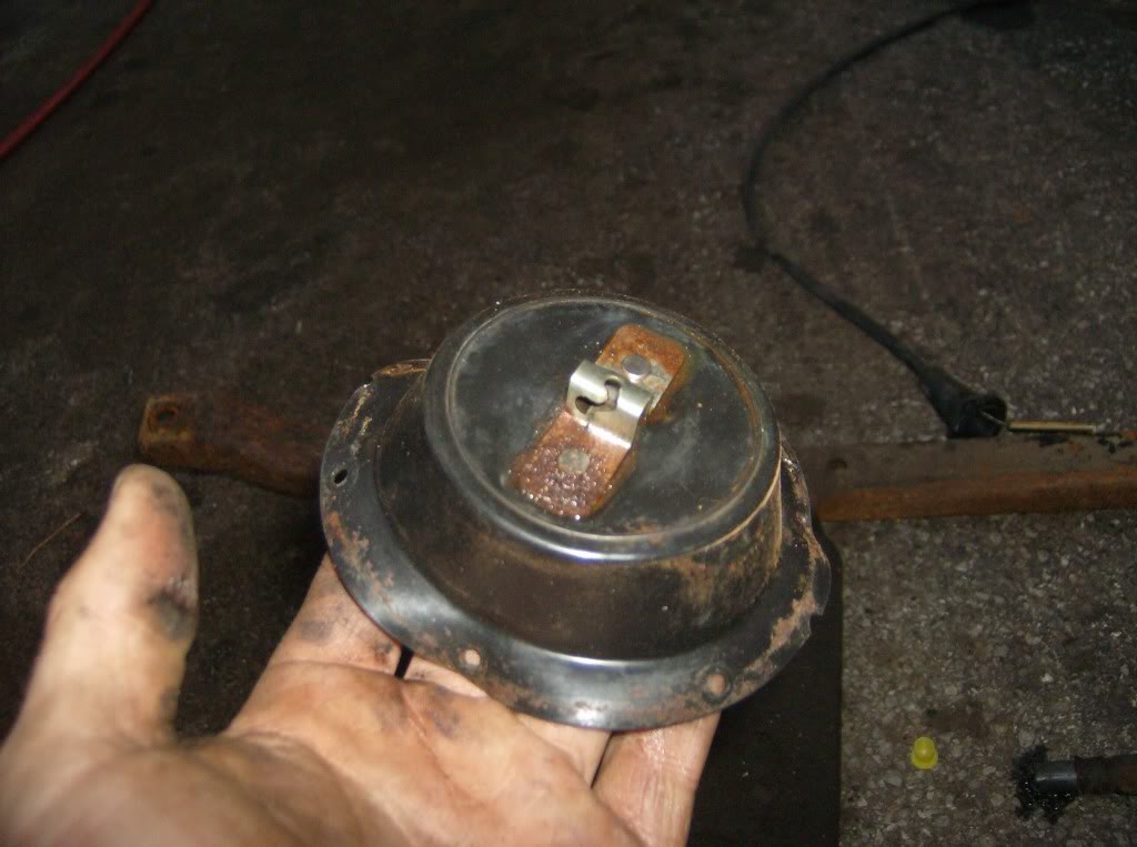

A closer look at what i call a maze hook

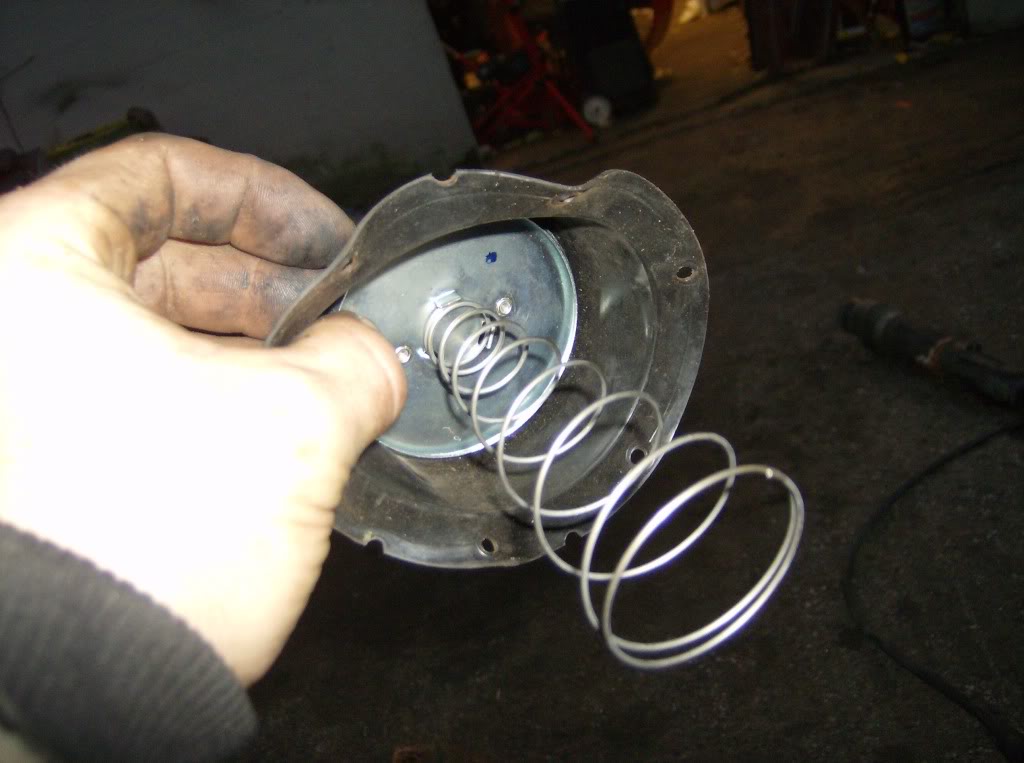

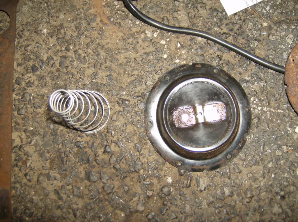

Your are going to want to push the spring into back of unit, the one was just laying on one side when i took it apart.

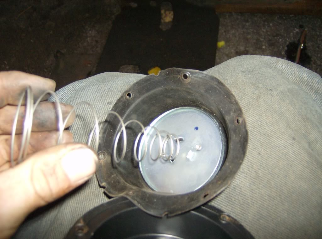

Another look

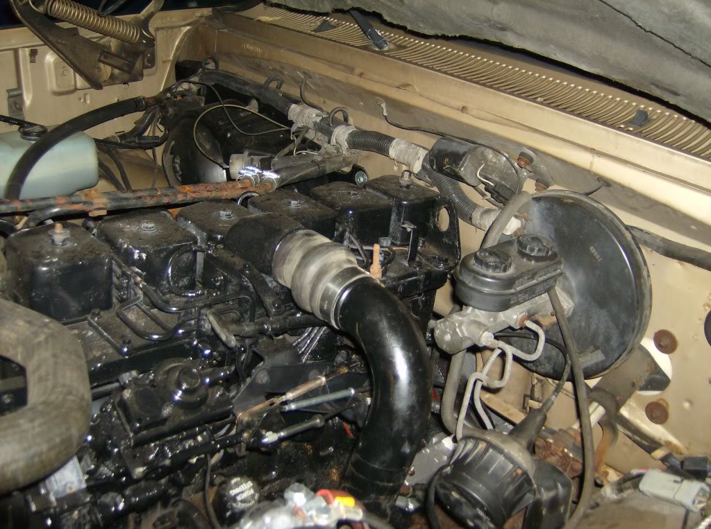

A look of it installed in my Ramcharger
