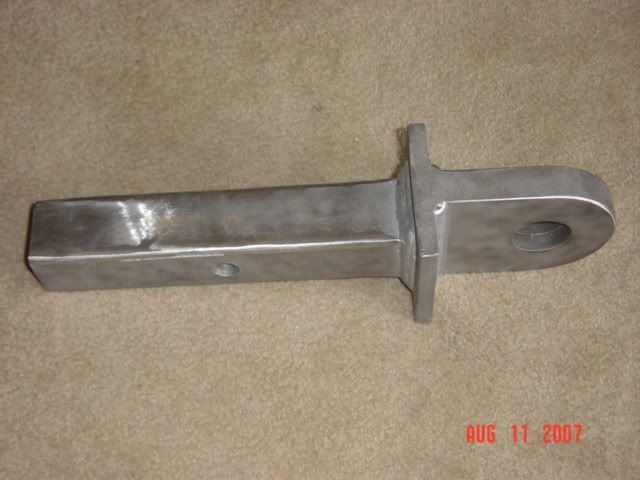

can this be used in a sled pull? or does it HAVE to be a rigid loop? I built it a few days ago to use as a tow point for offroad recoverys. But never thought about pulling with it.
It is 2" soild stock. 5/8" backing plate, with 2....1/2" laser cut eyes laminated together. powdercoated it at work too. The clevis is a 1 3/8" with a WLL of 13 1/2 tons. I'm pretty sure the ID is at least 3" in the center.
but here it is............please inspect

Yes, that will work fine but eventually you'll want something with more height and a stable horizontal hooking point.
