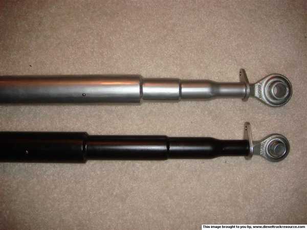

I highly recommend installing traction bars to put all that power to the ground and prevent carnage-inducing wheel hop due to spring wrap:

traction bars are a must if your going that much hp and going to be pulling.....it sounds like alot but you might want to throw a dana 80 axle under that dude...i know that sucks.....you can go crazy with power but you gotta have the driveline to back it up espically pulling with a 12 valve. people over look the drive line and it is very frustrating breaking alot not that im speaking expirence or anything again thank you for what your doing for our country
