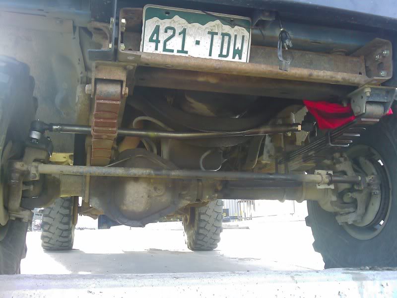

I did a crossover steering conversion on my truck. Hands down the best
modification thus far. It made the truck feel 10 years newer....
I made most of the parts myself. My front spring are just a leveling spring the the previous owner built with stock main leaves. Parts I used....
-Borgsen steering shaft
-Moved the factory steering box to the 2wd position on the frame
-The 4wd power steering lines will work just fine with a slight angle readjustment at the fittings.
-Jeep WJ pitman arm, alignment keys removed, retapered to fit a GM TRE
-GM 3/4 ton GM TRE LH
-Custom double threaded adjuster to allow the steering wheel to be centered ( poly performance offers something similar and more compact )
-1.25" solid drag link
-TRE adapter on the other end of the drag link.
-Custom built 1.5" tall 6" center to center steering arm
I had to but a simple bend in the drag link to get everything to clear at full compression.
Note: My truck uses a stock main leaf, but has a few extra leaves to level the front of the truck. If you are running a leaf pack that isn't as tall ( springpad to top of main leaf ) you need to make the steering arm a little less tall. I can get measurements if anyone needs them.
I have been running this system for a few months now, zero issues. I have not had anything rub anywhere, even after a trip to Moab.

I wouldn't suggest using the stock steering shaft. Those things are just junk. There are some junkyard options for a joint that can be used to replace the factory coupler at the steering box. I did the borgsen unit with the rag joint at the steering column.
It will be interesting to see how that NWF kit works out.
If your trying to use that kit with almost no lift you might have a hard time. The pitman arm looks to have too much drop and will probably cause the spring to hit the TRE under compression. The steering arm looks like it might be a bit long too also, this causes the drag link to hit the front lip of the engine crossmember. I am also pretty sure that the double bend drag link will be a tight fit at the first bend from the pitman TRE. I am NOT saying that the NWF kit is poor quality, I'm just saying that fitting crossover steering with almost no lift is way harder than it looks.
There are some areas that are less than 1/2-3/8" clearance on the steering system I built. I VERY carefully chose and custom built a lot of the parts so it would fit.
