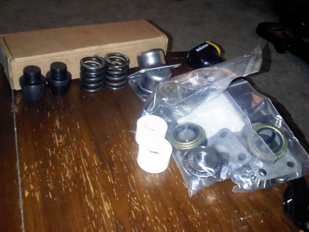

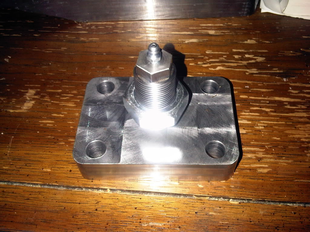

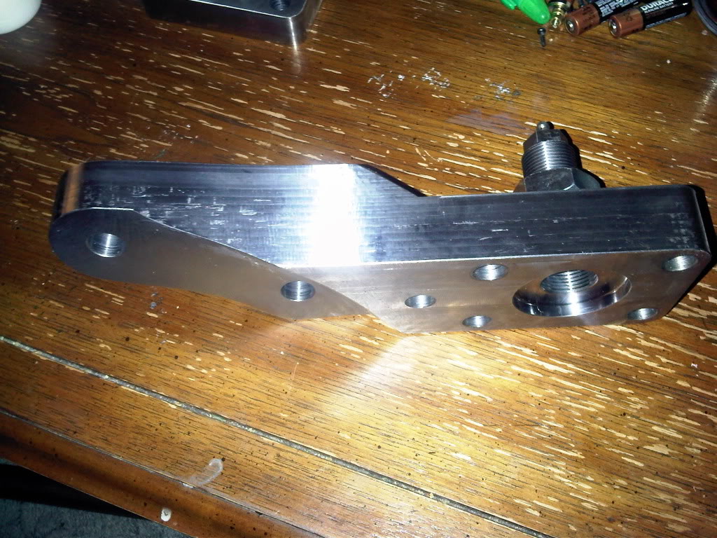

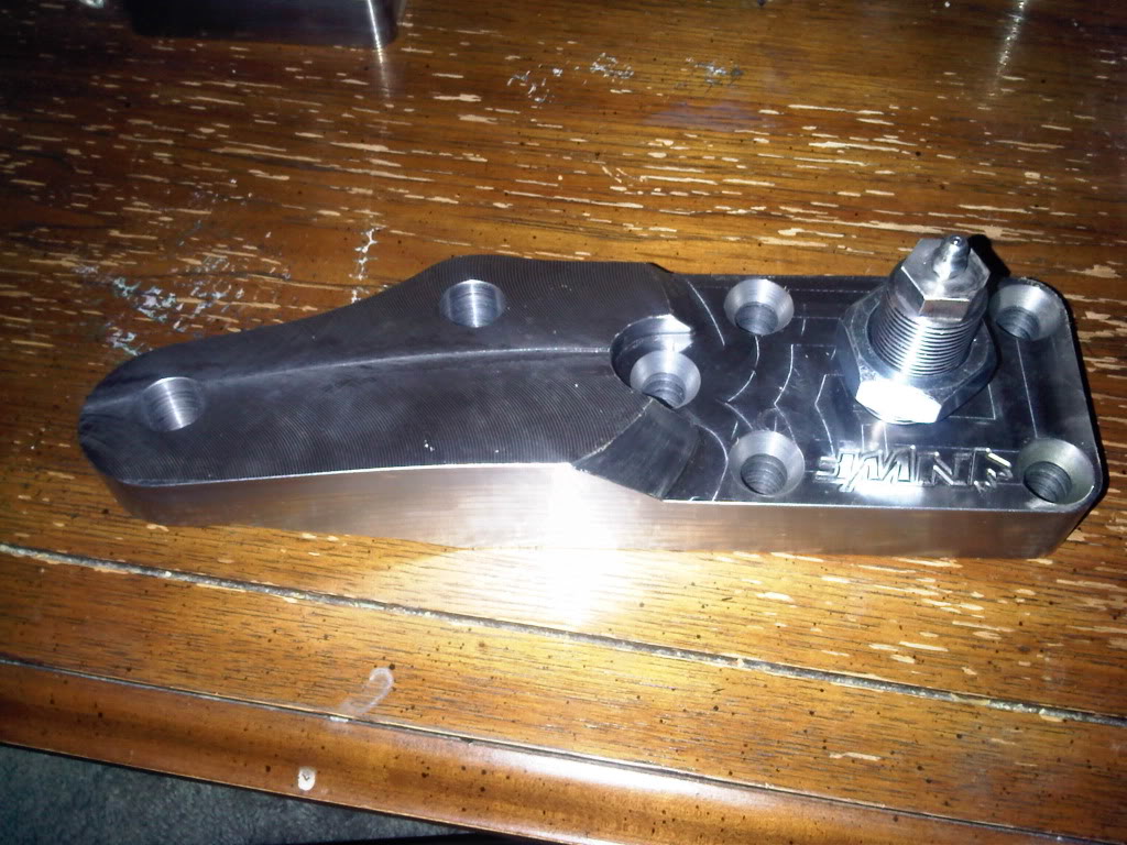

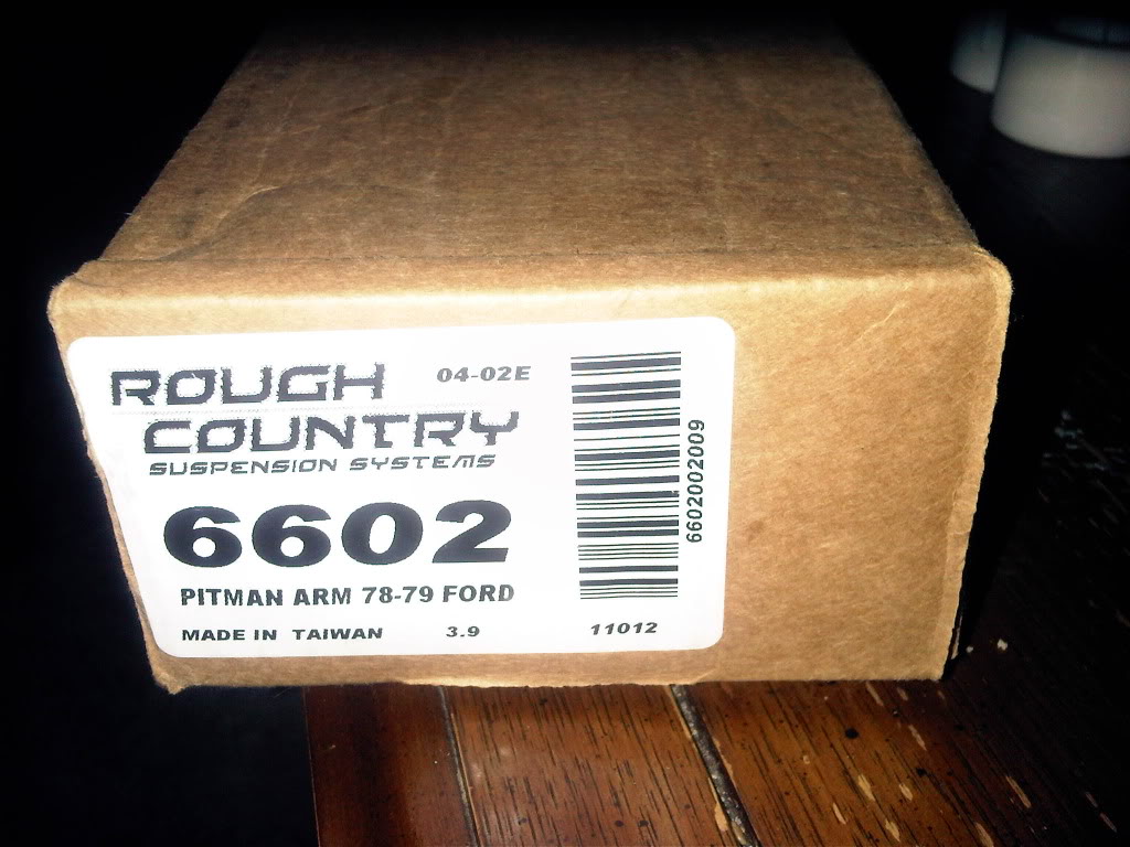

crossover kit w/additional drivers kingpin cap and rebuild kits

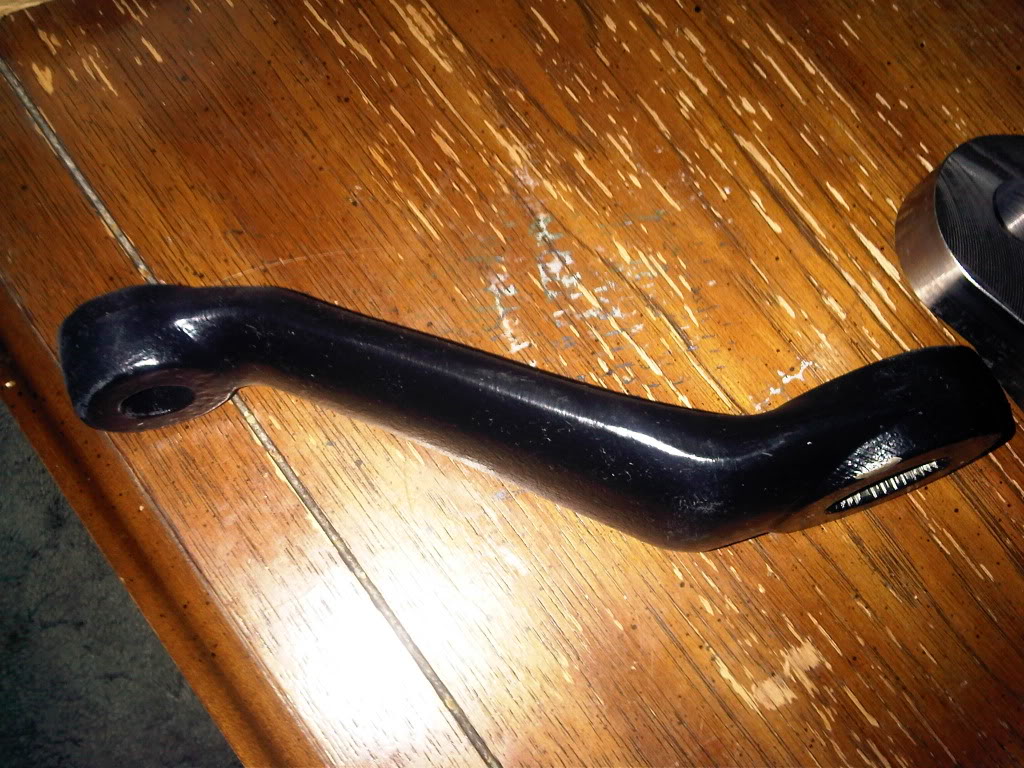

Mieser's Avatar
Posts: 171
What is the drop on the pitman arm?
What is the pivot distance on the steering arm?
I'm interested to see how it turns out for you.

[QUOTE=BILTIT;3002237]
where did you get these parts.... and what are the part numbers? PLEASE!! i have been searching local parts houses and can only get a few of the parts... no springs or caps or cones.... really want to tackle the front of my rig.
thanks
Old Aug 4, 2011 | 05:41 PM
BILTIT's Avatar
Joined: Nov 2010
Posts: 2,205
From: Lloydminster SK/AB
http://www.northwestfab.com/axleshafts.html
OR
https://www.4wdfactory.com/store/pro...in-Rebuild-Kit
Everything you need to know about the D60 front axle with spicer/dana part numbers:
http://www.pirate4x4.com/tech/billav...ont/index.html
I will have the caps and springs up for sale if you need, also have two spare bottom bearing kits.
Drop=3''
Pivot c-c=6.5''
That is part of the reason i went with NWFab, close to me so i can have them iron out the wrinkles if any issues. I know another member is having issues with a highsteer kit from them and said they are helping him work it out.

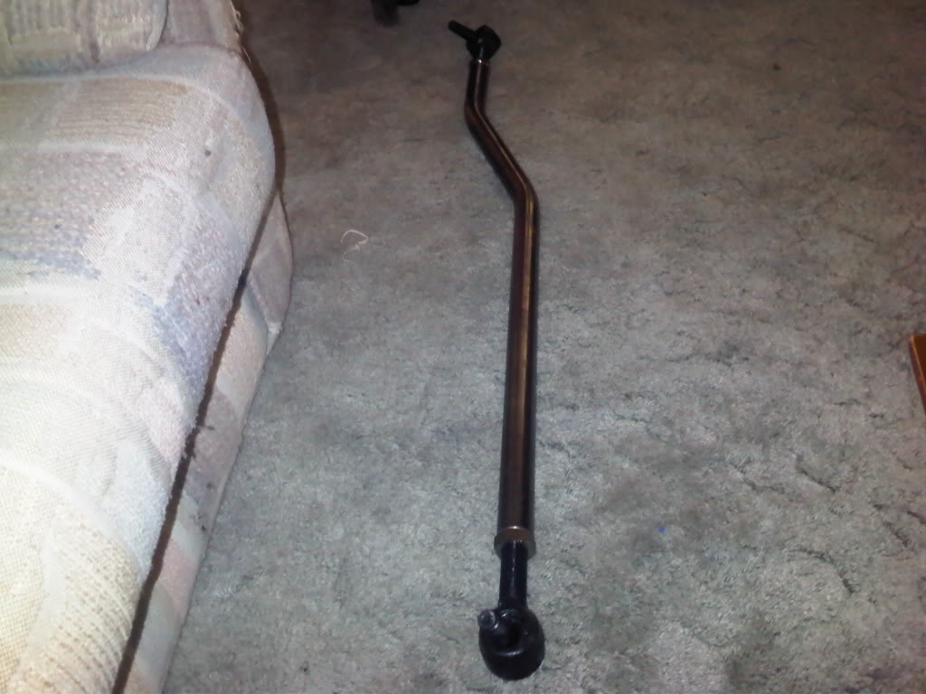

-Be prepared to trim out the front lip of the engine crossmember. It is going to be VERY close since your steering arm is a little longer than mine. Mine is 6" center to center and BARELY clears.
-Be careful with that pitman arm. Is it really only 3" from the mounting spline eye to the TRE eye in drop? Or is is a '3" drop pitman arm'. The part number comes back to a F150 'drop' pitman arm. If the arm is too low the TRE will be too close to the stock main leaf. The WJ pitman arm I used was the only arm I could find that would put the bottom of the TRE the same as the steering box splined shaft threads. In my setup the spring would hit the steering box at the same time as the TRE. This is the most clearance you can effectively use.
-Depending on the length of the pitman arm ( and its drop ) the double bend drag link should clear ok. The drag link will probably slope down from the steering arm also.
Doing crossover on a stock height truck is challenging for sure.

Here is how i measured, probably should have included the thickness of the arm itself though or measured it differently.
