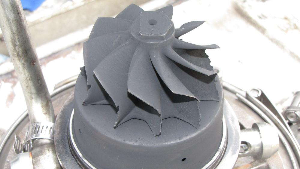

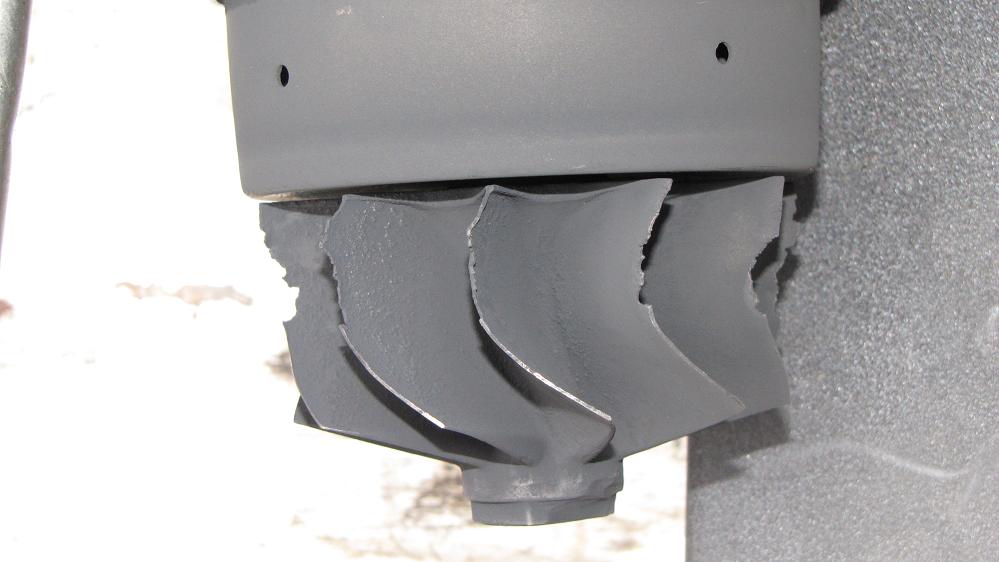

Well, since this thread is all over the place, I'll make my little plug. Say hello to the newest addition to my family!
Attached Thumbnails turbos-bad-turbo3.jpg   turbos-bad-turbo2.jpg   turbos-bad-turbo1.jpg
Old Nov 8, 2010 | 05:07 PM
  #68
Tate's Avatar
Posts: 7,780
From: Airdrie, Alberta
Oh, by addition, I meant potential paper weight.

I wonder what got spit out of the exhaust to do that? And should you be pulling the head to check?

Yuk. What did the housing look like?

Housing is fine. The damage is right by the nozzle ring. The damage happened since it went in as a single, so in about 30 km. I was wondering if it was heat fatigue, since it did see a lot more heat then than it did in a twin set. I'm gonna post on CompD and see what those guys have to say.

Without seeing the turbine disk first hand, my guess is it look to be fod (foreign object damage). The damage doesn't look burnt or melted.

Nasty kill on the turbo Tate, tuff luck buddy. Looks like the turbine disk started to fall apart. Seen a few GT37 like that at Alamo
