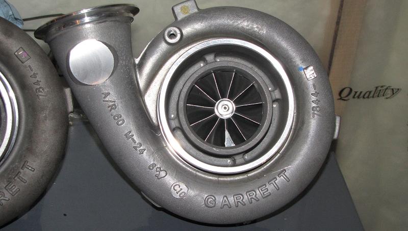

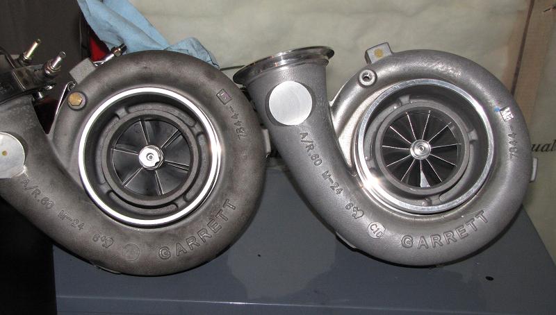

Since I had my damage turbo pics in this thread, I'll post some more. Say hello to the new member of the family.
Wow, very nice. Bro can't wait to see them installed.

Looks better than the last new addition! Is that the GTX37?

Its bigger and badder than a GTX37. Just saying enough.. One is really big...

GTX4202. Hopefully have it in this weekend. Just need to make some arrangements for accommodations.
