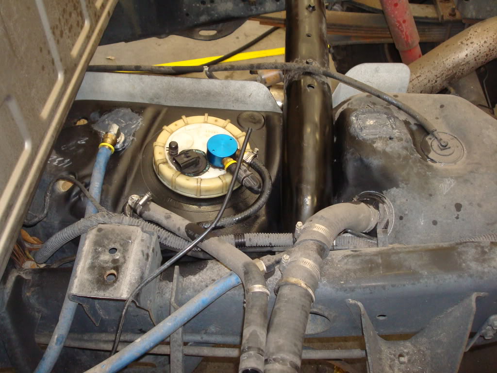

Yeah, you're gonna have a hard time going under the bed because of the fuel tank...

Madhat, how does your fuel gauge work? I didn't see it hooked up.
What kit are you using on the tank? I want to modify my 2010 so I can run a fass system. The 2010 has a in-tank fuel pump and I don't want to cut to many wires or put holes into the tank.

I had the wires unhooked. It still runs from the fuel sending unit.
Had to patch a couple of holes... so I pulled the canister out.
What kinda of fuel pick-up you running from the tank? Looks like decent sized lines, and it might flow enough fuel.

They're just air dog lines. 1/2 inch. The pump normally keeps me at 17 psi, and at WOT I can pull it down to about 10 psi.
I'm thinking about just installing a sump and some 3/4 PVC or something....

Where is your fuel pressure gauge located at? Might have to copy some of your handy work for the 2010 truck. Been scared to drive it as I want to install another fuel filter system and get rid of the stock pump. You running two CP or going the big CP route?
