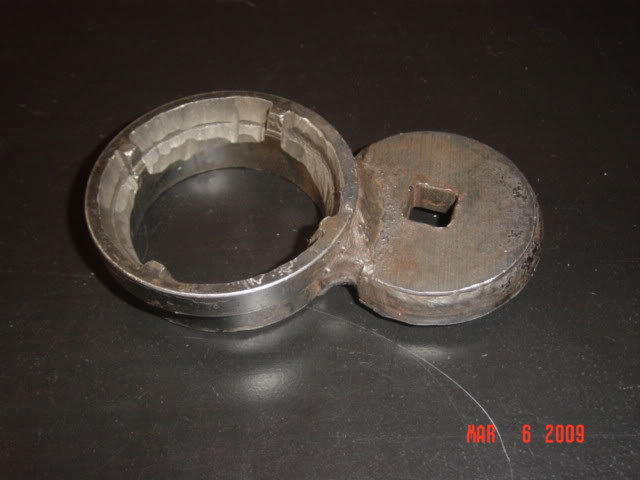

Big thanks to Steve (ram4by) him and his son Sirus (sp?), they stopped by for a couple hrs last night, and helped me get to the point of tightening the nut on. Just need to make a couple quick welds tonight, let it cool and put it all back together.
Diesel Dave2 The nut tool worked awesome, However silly me forgetting that 2wd have a bigger output shaft...
So the holder tool didn't work for me.
It really would have saved a lot of time
We had to use a combination of putting the driveshaft back on putting it in gear, and pulling so hard I thought the ratchet was going to break, but we got it on and done. It is prepped and ready to weld.
It really would have saved a lot of timeWe had to use a combination of putting the driveshaft back on putting it in gear, and pulling so hard I thought the ratchet was going to break, but we got it on and done. It is prepped and ready to weld.
