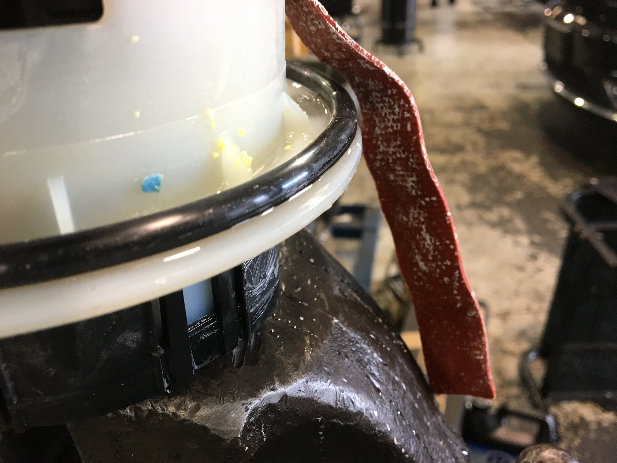

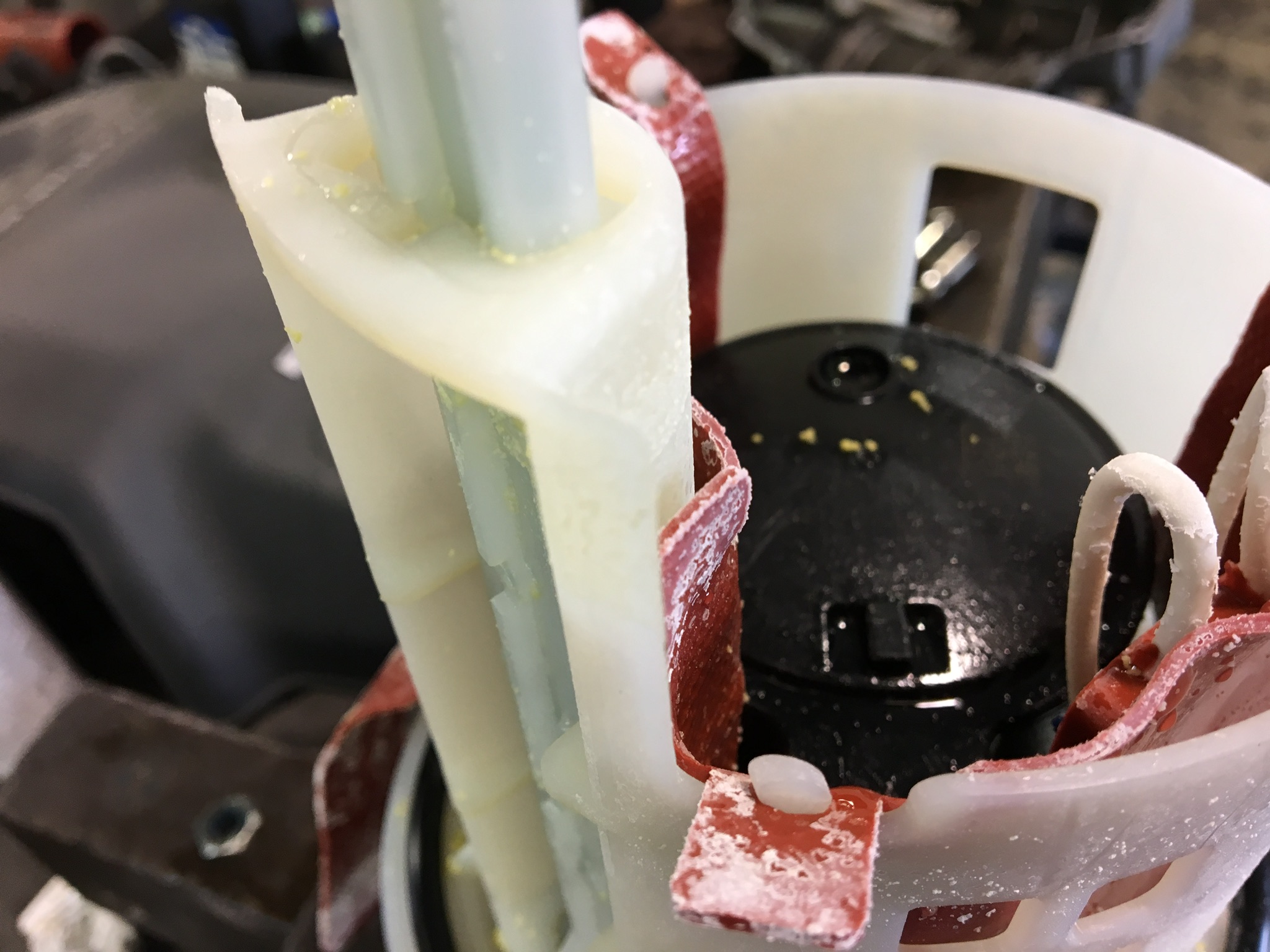

Needless to say, while at the dealership earlier today, the technician showed me the inside of my DEF tank and the pump he had removed. There were numerous small globules of a yellow substance (technician said it was oily). Also, mentioned that he's never seen anything like this.

Will post pictures of what I saw today. Only have pictures of the pump, but globules were everywhere.

Whatever it is, it looks like the filter stopped it and it did not get into the system

impurities in DEF
