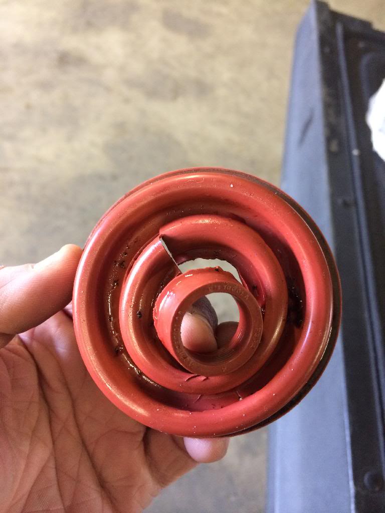

Did a lil investigating, it seems to be coming from the top of the tranny, some digging and I found what seems to be a common issue.
Crap!

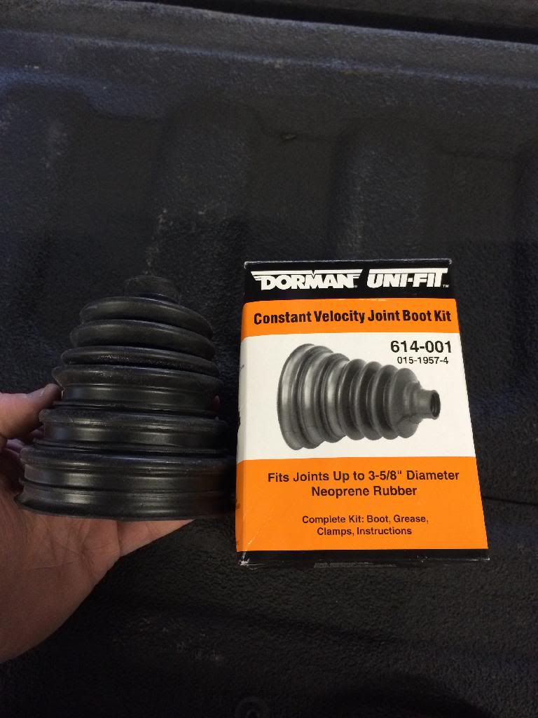

Ran over to O'Reillys, got a Doorman universal CV Joint boot, part number 614-001.

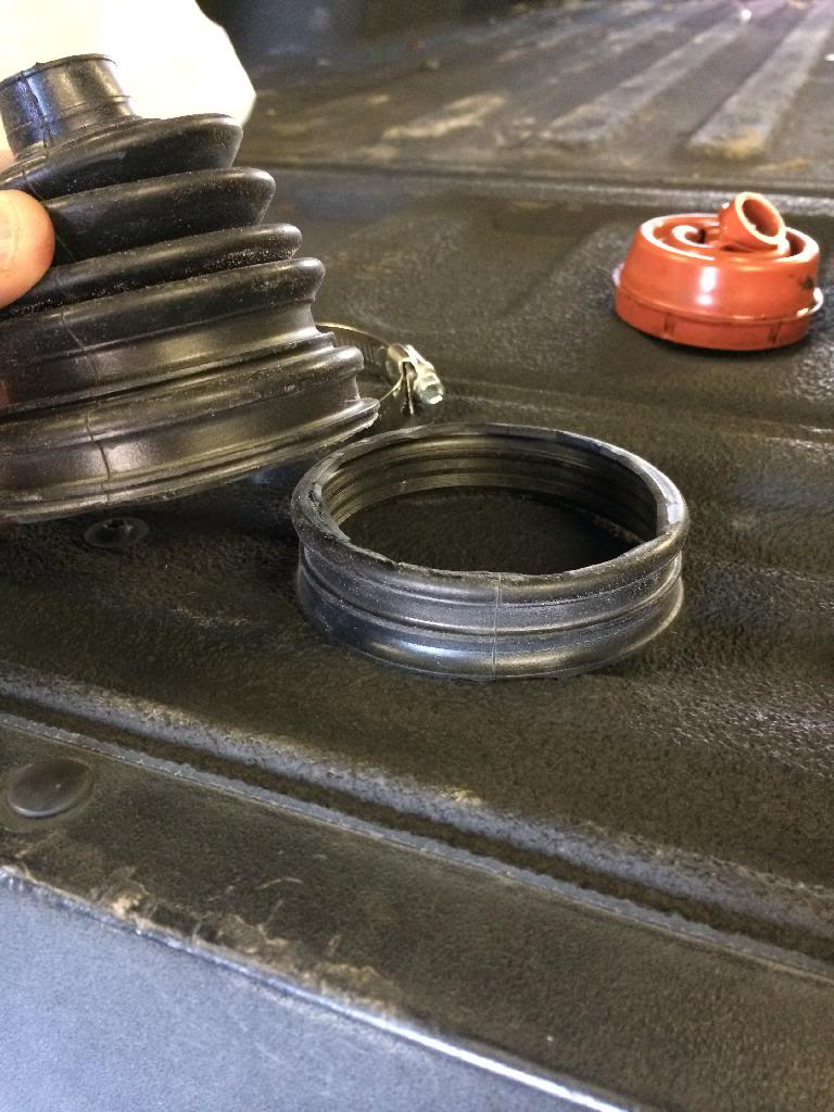

Trimmed the lower section off and gave it a nice snug fit to the top of the shift tower.

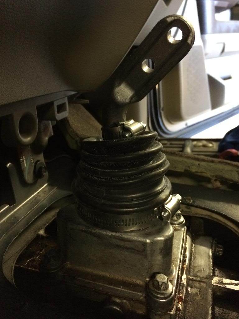

A couple of stainless hose clamps later, and its good as new.
Twenty bucks all in. Works for me!

Did the same thing a couple years ago. Still holding up with no leaks. CV boots are way heavier than that cheesey shifter boot.
