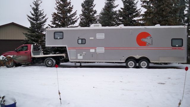

Last two weeks I pulled a 9K pound fifth wheel down to California and back after 4000 miles I used 5 gallons of DEF too.
DEF here in Canada is expensive compared to the US prices so I stocked up on it with a few jugs.
Did anyone found a way to delete the DEF system?

Traveling 60-65 I got around 11 MPG.
I have a Work and Play with the rectangular flat front not the most aerodynamic trailer around, a wing on the truck or a rounder front cab on the trailer would improve the MPG.

Yeti,
check these out:
http://www.nosecone.com/aepull.htm
