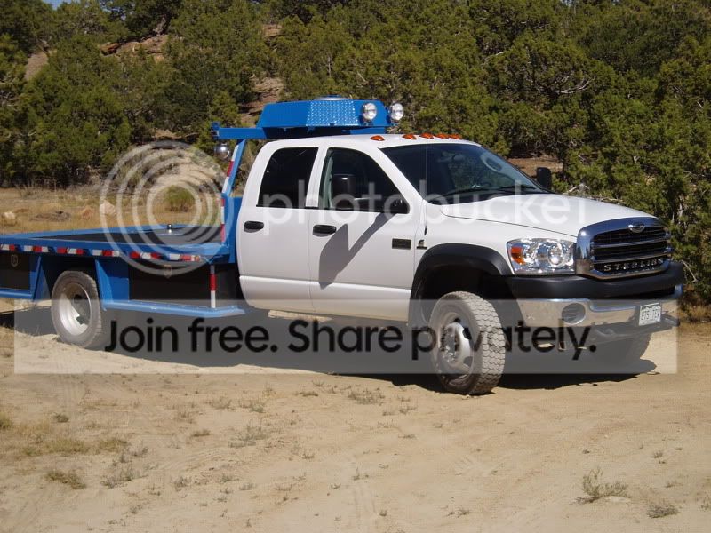

Got the truck bed on my truck.
I love the small lights on the side of the bed when I'm backing up to park the truck along a wall I can easily tell by the size of the red reflection on the wall how close I am to it.
The step in the center to get atop the deck is nice detail.
Mounting the bed on the truck was easy too.
Overall the craftsmanship is great the welds are a pleasure to look at.
