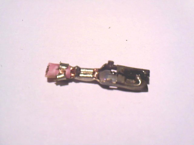

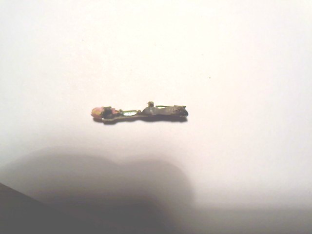

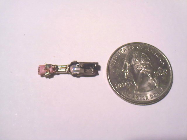

Cannot find the right terminals to repair the blue pin connector that plugs in to the drivers window switch panel. Had one short out, melted the plastic that surrounds the pin which coated the connection. Only way I could see to fix it was remove and cut the offending terminal and try to find a replacement. Long story short, I can't find this terminal, any ideas?

picture maybe would help some for use that don't have a 3rd gen to look at

Posts: 37
Pictures
Pics
Attached Thumbnails Wiring terminals for the power window switch connector?-1129092353.jpg   Wiring terminals for the power window switch connector?-1129092346.jpg   Wiring terminals for the power window switch connector?-1129092344.jpg   Wiring terminals for the power window switch connector?-1129092343.jpg

Went by the dealer today, was able to get a replacement connector to some other chrysler car. Basically it had the same female connectors already crimped onto some new wire, I simply cut one off with a length of wire attached and crimped it onto the old wire with a copper sleeve, heat shrinked it and it is now fixed.
