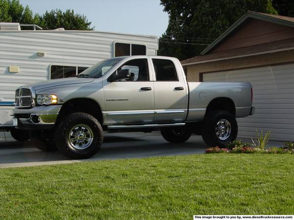

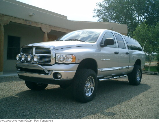

eagle #114 w/tires
Here's the setup I have been wanting -one is toyo mt's & the other has the nitto tg at's.
