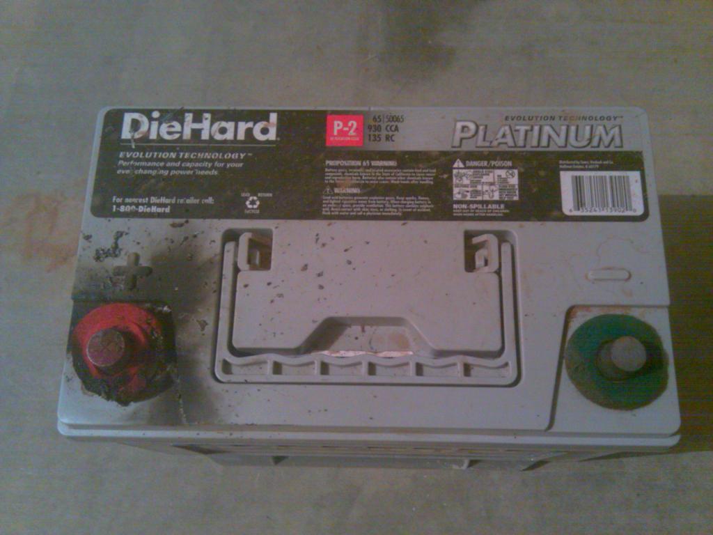

What could cause this? (pic)

What could cause this? (pics)
Just found this today after my check gages (low voltage) light came on. Two brand new (bought 2 months ago) Sears P2 $200 batteries. I posted in the HELP section earlier but need to get my rig back on the road for a long trip asap. Is it just a bad battery? What could make this happen?
There was a thread on here some place about a wire between one of the batteries to the ECM, and if it gets corroded the ECM sees no voltage from the batteries, so the ECM turns the alternator to full output.
Other than that, high resistance at the battery post/clamp? Tarnished or oxidized?
That battery terminal was on fire!
If it had been wildly overcharging you would see signs of battery acid bubbled out over the battery, plus you would have gotten a dash light indicating the fault.
About the only that would cause that would be arcing caused by a loose connection.
Is it possible the Sears "mechanic" failed to clean the cable end clamp or to tighten it properly.
Beyond that these era Dodges were quietly notorious for spontaneous battery fires.

Not sure about the loose connection. I installed them myself, and scrubbed and cleaned the terminals, put the felt corrosion protectors on, and tightened em all down extra firm. There was no play that I know of, but then again I didn't recheck. Never thought about it being an issue on any battery I've changed. Seems bare wire arced somewhere, but today I went all over the engine bay and didn't see any wire worn or exposed.
I took them in to Sears and both batteries were dead. They're being recharged to see if they'll hold; so I'll know more tomorrow. Could it of somehow been the alternator going bad? Just want to rule it out.
But, as per Jeff in TDs post, a low voltage reading to the ECM because of a corrosion (which I didn't see any) or a loose wire could have caused the overcharge. Still investigating.

Kinda what I was thinking when the guy put the tester on and found em both drained (almost). Funny thing is the fried one still had a little juice left in it; and the other was a 60lb paper weight.
Time on the charger will tell. Once the batteries are replaced (personally I'd replace both) I'd be sure to look at charging voltage at the battery posts of both batteries with a pocket meter.
