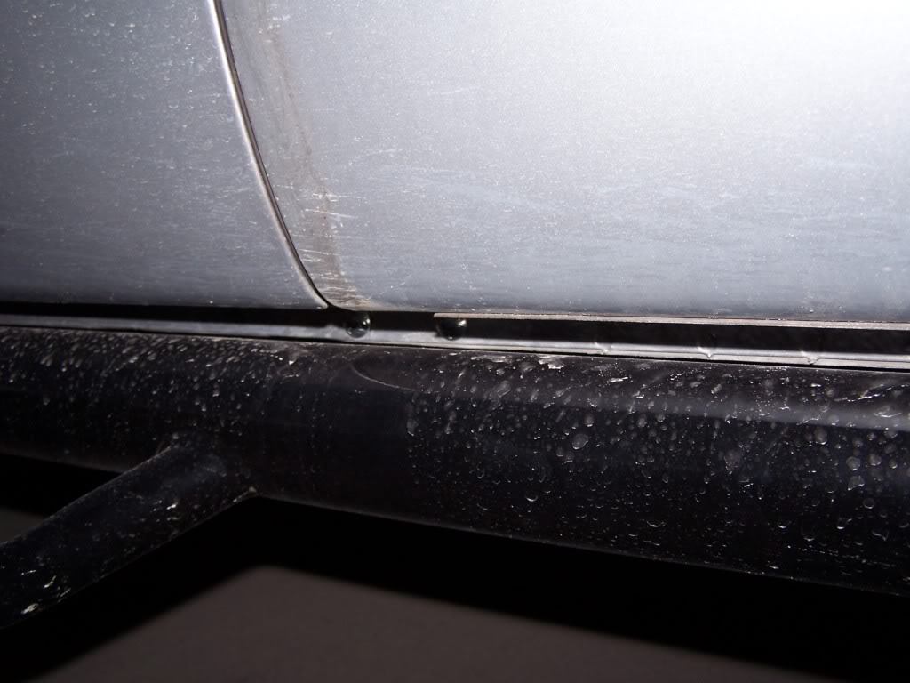

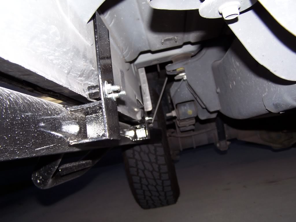

Can someone post picts of how there NFabs are mounted? I got my 6 step NFabs today and those buggers are pretty heavy. I want to make sure I am installing them right before I start making holes in my truck.

Here's a couple pics of my four step N-Fab's

Old Dec 1, 2009 | 02:17 PM
bansh-eman's Avatar
Posts: 1,719
From: Houston
thanks man. Thats exactly what I needed to see.
