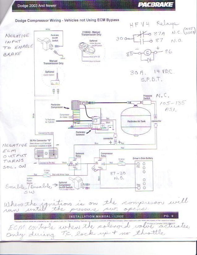

Check the ECM pin 42 wire, it runs to the 85 pin of the Solenoid relay. You will fine the ECM is sending the ground signal the dropping and so on and so on. Try a Throttle Position Reset, if that does not cure it see dodge for a reflash, extreamly common on 2006 and 2007 trucks, very rare in the years before.

As said you may need a reflash,I would email or call Harold Mclean at Pac Brake (harold@pacbrake.com) or 604-882-2332.On my 06 if the brake switch is on and you give it a little throttle and then release the throttle quickly ,you will hear the exhaust valve chatter.It is very suttle though, sometimes not very noticable at all.This is a known problem,that a reflash is supposed to fix,but since I switch my brake off and on quite a bit I have never bothered to get it reflashed.Have you actually watched your exhaust valve to see if it is chattering,you may need to use a voltmeter to some checking.Terminals 85&86 of the solenoid relay would be a good starting point,with the brake sw turned on there should be approx. 12 VDC across the termanals until the engine is almost warmed up,if its not steady you either have a flaky connection or the ECM output is not staying low.If you find it easier just check your voltage at the solenoid.Sorry my drawing is not the best,I have added notes and drawn in the relay coils.
Attached Thumbnails pac brake randomly turns on and off quickly-pacbrake.jpg
