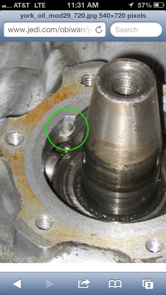

I used 208, 209 and 210s in the 70s to make electric motor driven compressors. I always pulled the head and plugged the oil drain hole on the suction side. After using it for 30 yrs, I just scrapped a Thermoking/Trane 214 that I ran with a 3 hp 3ph motor, running on single phase with caps and a potential relay. It had a lot of coked oil on the valves but it still pumped fine. Craig

C Schomer, are you talking about plugging this hole on the suction??
