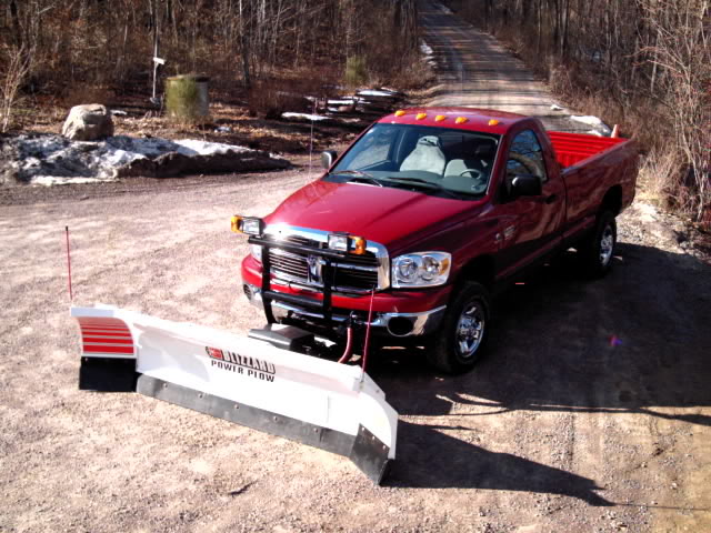

On my 2007 Ram 2500 CTD LAST of the 5.9's I also pulled the # 30 QUOTE ( SPARE ) as it was labeled to use it to power the snow plow controler in the cab so it would power on and off with the key that led to the ABS-Brake light -and no speedometer I backtracked replaced the fuse and everything was fine lights went back out and the ABS was functional again.
