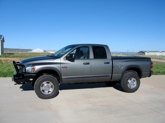

Well, I won't have any issues going with DuraFlap's rear mud flaps on my 3500, but it looks like there are going to be some clearance problems with the front.
First off, here is a side shot of my front drivers side tire showing the 2-1/2" clearance to the front edge of my Bushwacker Street Flare:

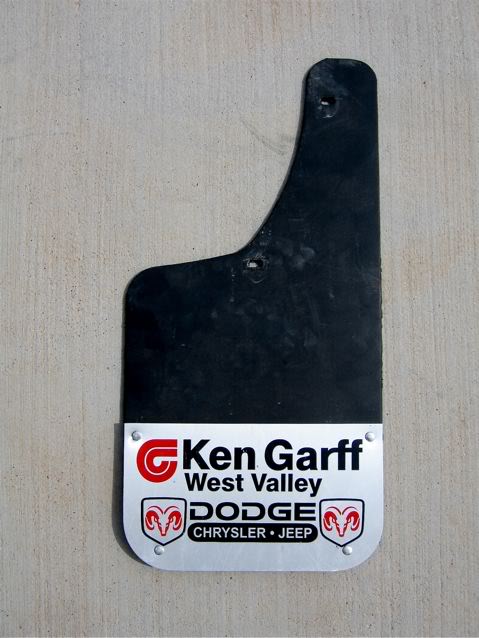

I used one of the "El Cheapo" dealership mud flaps that initially came on the rear of my Dodge 3500 to jury rig a "simulated" mud flap for the front drivers side wheel well. Note that this mud flap is only 10-1/4" wide at its widest point:

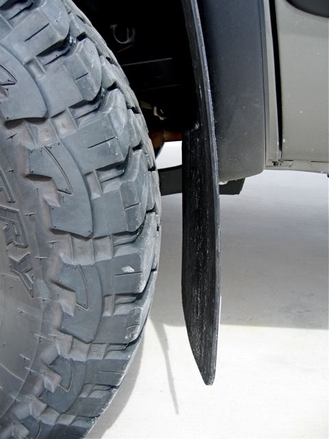

Here it is temporarily installed on the front drivers side (the black wedge/shim is there just to force the flap to hang more vertically once it goes below the Bushwacker Street Flare edge):
And here is a side shot of the same mud flap (with the front wheels straight ahead):
In this shot, I have only turned my wheels about half way to the left, and I am just contacting the front surface of the mud flap:
Now here is a shot looking downwards with my wheels at full lock left. Again, keep in mind that these dealership mud flaps are only 10-1/4" wide:
Although this shot was probably not needed, there is clearly no interference between the mud flap and my front drivers side tire at full lock right (although there obviously would be on the passenger front tire):

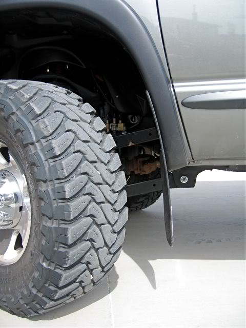

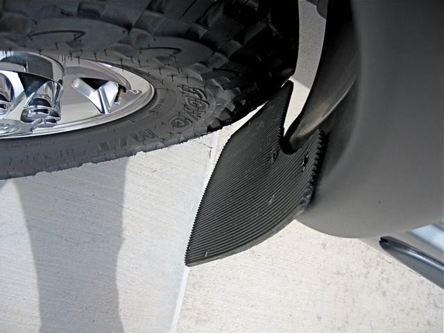

I had a good conversation with Dennis Perry at DuraFlap on Tuesday. He is shipping me 14" mud flap "blanks" along with a piece of Plexiglas for me to come up with a prototype template for the best fit for someone with a Dodge 2500/3500 with 35" tires and Bushwacker flares in the front. He sees a market for this and plans to come up with a separate part designation once he gets the prototype template back and CNC's a precise unit. I will then get the first set of the final version for my front wheel wells. I really didn't expect this, but I am glad that this will allow me to get the best fitting mud flap for my particular application (and it benefits Dennis with a new product). In the meantime, I will install the 14" DR-9-SS mud flaps in the rear of my 3500 (which should pose no clearance issues).
Since clearance was definitely questionable on the front of my '07 Dodge 3500, I initially focused on that and I am happy to report that I got the front DuraFlaps to work with my 35" tires. I am able to make full lock-to-lock turns with adequate clearance. Once I get the dimensions and mounting holes transferred over to the Plexiglas template, I will take on the rears (which we decided to do on a custom fit basis as well).
