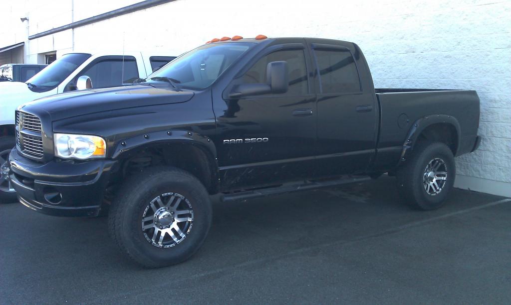

I have a 3500 srw with 4.10s and a auto. i leave my programmer all the way up at all times and i drive fairly conservitive. I hand calculate 18.5 to 19 everytime. I am running 315s so it egutes to about a 35. ive got a leveling kit and painted to match fender flares. The combo looks great and i have good power with my truck and still get good mileage i think for a slightly lifted auto with 4.10s. Depending on your tire size u will need a leveling kit. I recomend a 3in kit wit the 35s, levels it out straight and doesnt rub. i am also running aftermarket eagle alloy 17s. As for your programmer, it should change your speedo and odo to match the tires, mine did and it was a big diff. Hope this helps.
