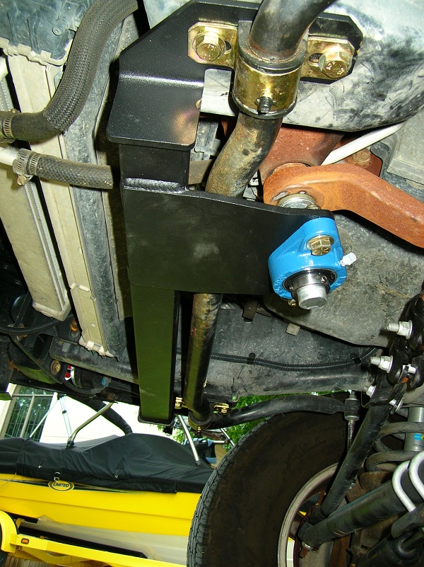

For my setup, I have to back out of the driveway away from the garage, where the orange ext cord is coming from. So, in my case, assuming I'm blind that day as I walk out of the garage, the plug should disconnect from the truck as I back out. Hopefully not pulling the 10' bench the cord is mounted too and wrecking the floor standing drill press next to it
So the fuzzy tabs are the frame clips? I ordered my cord from Geno's and no clips were included. I sourced cord holder push pins from Lowes and popped them into the rail to run the cord. Worked pretty well. You can see the cord along the frame rail in the pic. I did cover with some wire loom just for a little protection.
For the bumper mount, check Geno's. They have one you can mount to the factory bumper. http://www.genosgarage.com/searchprods.asp
