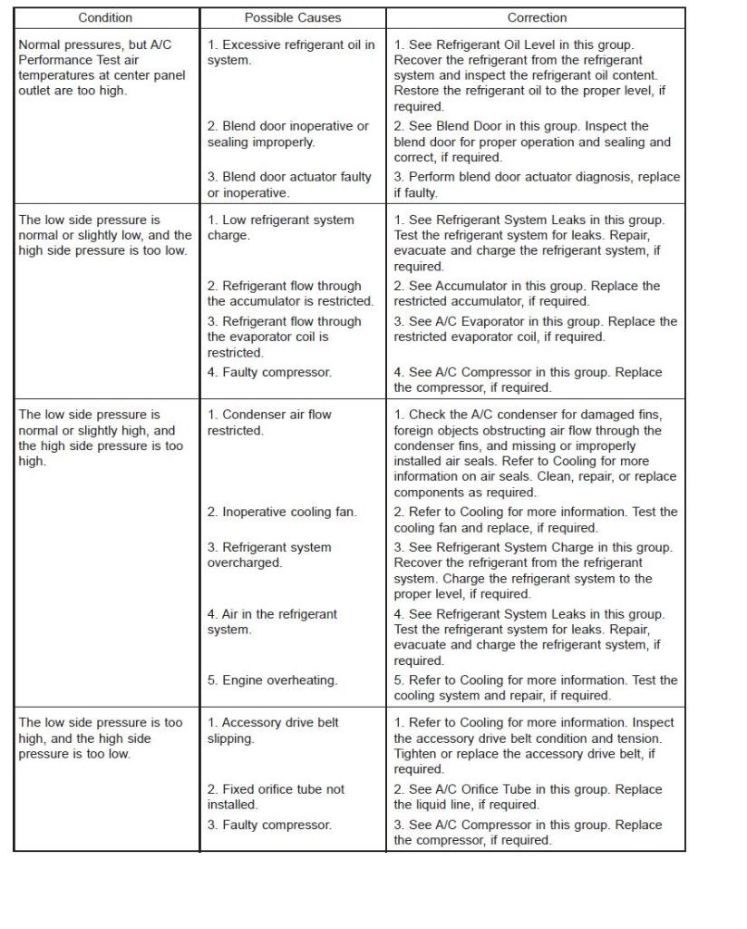

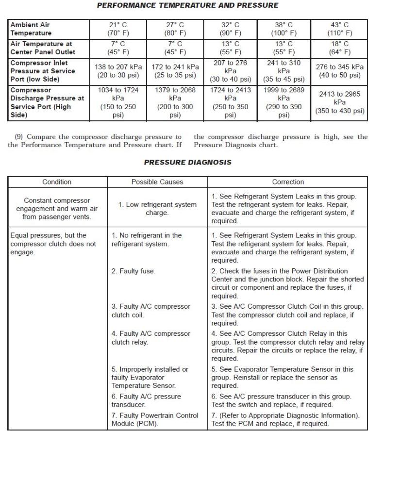

PERFORMANCE TEST PROCEDURE
Review Safety Warnings and Cautions before performing
this procedure (Refer to 24 - HEATING &
AIR CONDITIONING/PLUMBING - WARNING) and
(Refer to 24 - HEATING & AIR CONDITIONING/
PLUMBING - CAUTION). Air temperature in test
room and on vehicle must be 21° C (70° F) minimum
for this test.
NOTE: When connecting the service equipment
coupling to the line fitting, verify that the valve of
the coupling is fully closed. This will reduce the
amount of effort required to make the connection.
(1) Connect a tachometer and a manifold gauge set
or A/C recycling/charging station.
(2) Set the A/C-heater mode control in the Recirculation
Mode position, the temperature control **** in
the full cool position, and the blower motor switch to
the highest speed position.
(3) Start the engine and hold at 1,000 rpm with
the A/C compressor clutch engaged.
(4) The engine should be warmed up to operating
temperature with the doors closed and windows
open.
(5) Insert a thermometer in the driver side center
panel A/C-heater outlet and operate the engine for
five minutes.
(6) The compressor clutch may cycle, depending
upon the ambient temperature and humidity.
(7) With the compressor clutch engaged, record the
discharge air temperature and the compressor discharge
pressure.
(8) If the discharge air temperature fails to meet
the specifications in the A/C Performance Temperature
chart, refer to the Pressure Diagnosis chart.
Old Jun 27, 2010 | 01:19 AM
madhat's Avatar
Administrator/Jarhead
Posts: 14,999
Likes: 33
From: Jonesborough, TN
I did not see anything about freezing up. Normally, I would assume that you had low refrigerant, however, you said that you have good pressure. I'd look at your orface tube to see if that was clogged. I'd also make sure that the condenser was cleaned. If the high pressure switch was going out, normally it would not engage the compressor, and simulate a compressor failure, however, I guess it could keep the clutch engaged the entire time. Does your clutch engage and disengage, or does the compressor run all the time? This sounds like a switch failure to me. I'm not an AC expert by any means, but this is what I could come up with.
