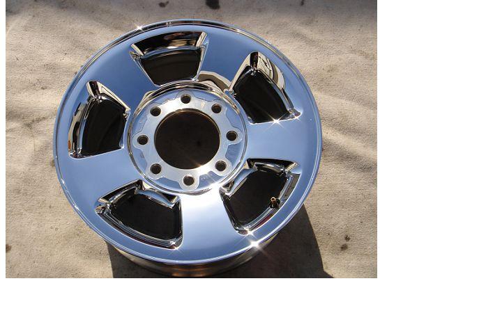

It's the right wheel
Picture of 2003-2008 wheel. When I get some free time will go at the corrosion.
Thanks for the replies!
