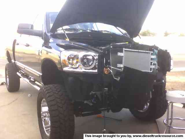

Here is the front end torn off!!

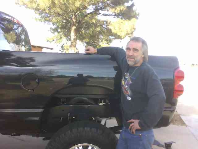

THe ugly mug in the pic is my buddy who is a tech at a local GM shop. He is 6'2" so that gives you an idea of how tall the truck is. This shot is just after completing the bed. The entire process took a FULL day. Breakfast to past dinner!
