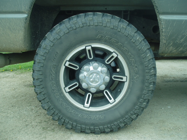

Here's a pic of mine. They are a little dirty, but I went with a med gloss. After about a year there are a few chips that are only noticable up close. Not sure what could be done to prevent this.
Those look sharp & different. Was it spendy to leave the machined area uncoated like that?
