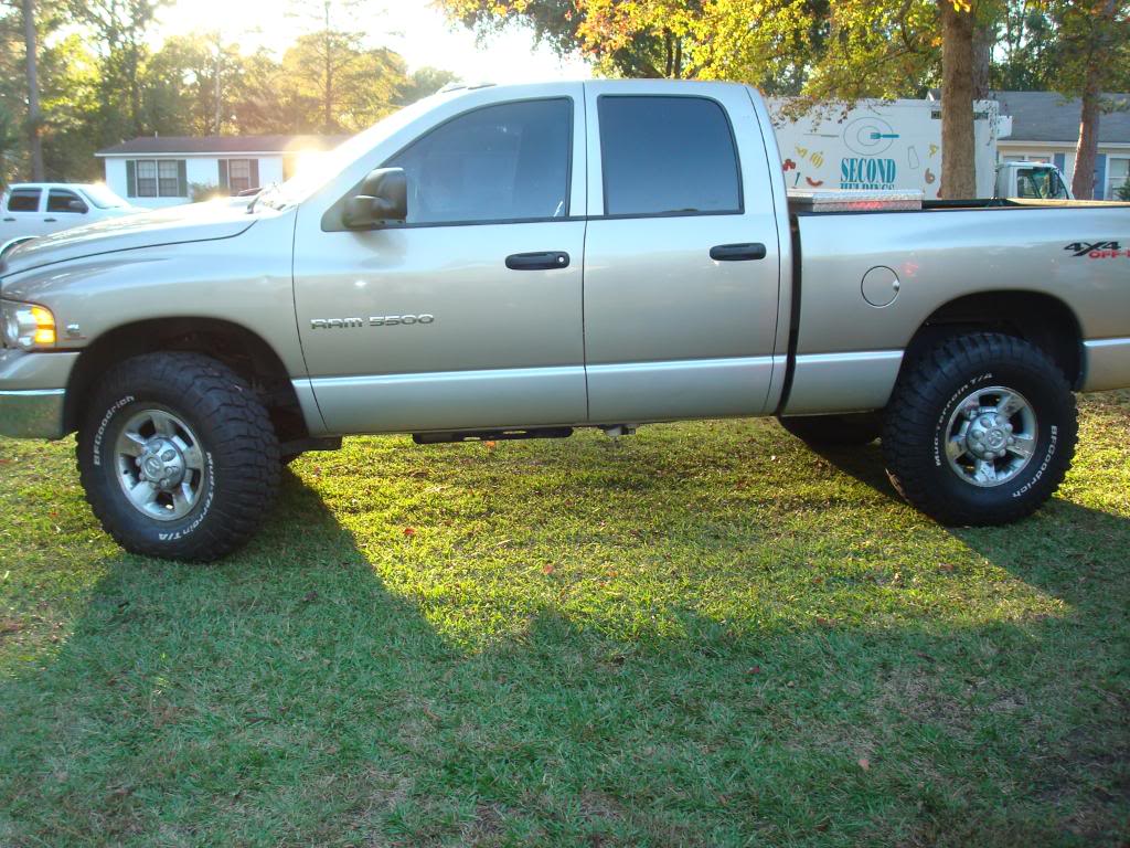

Thanks for the help. I got to fill those wheel wells up. Looks pretty bad.
Attached Thumbnails Biggest tire for stock truck-truck.jpg   Biggest tire for stock truck-truck1.jpg

With 37s...
