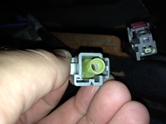

Un plug connection and use a female connector to slide onto the pins. I crimped them slightly first to ensure good connection. Been bouncing around under there for a year or so without any problem. I do not know the technical difference for this piece but mine is an 07 5.9 .
Attachment 39512
Or you can try the easy way!
