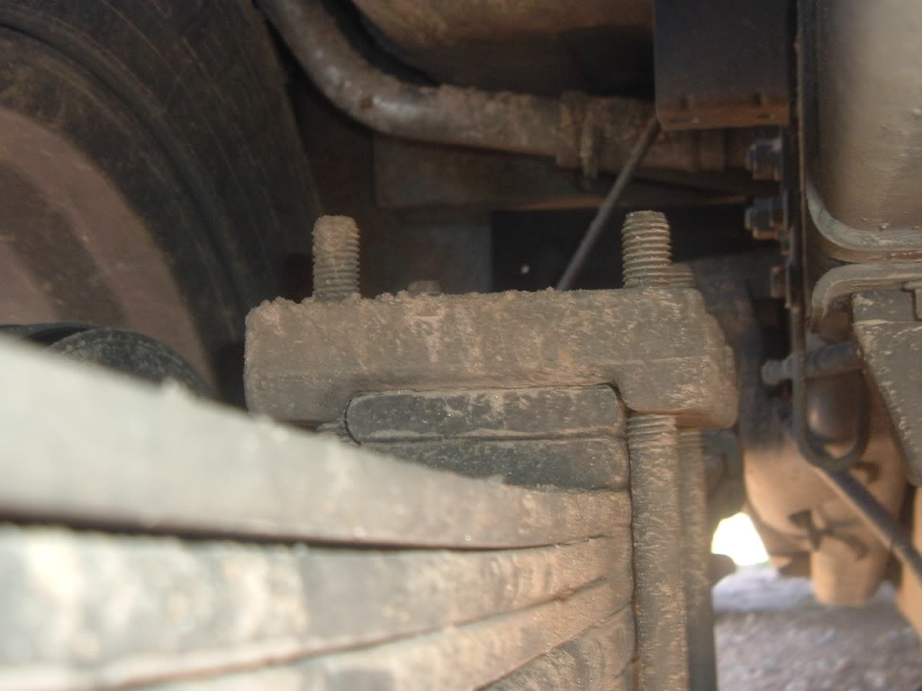

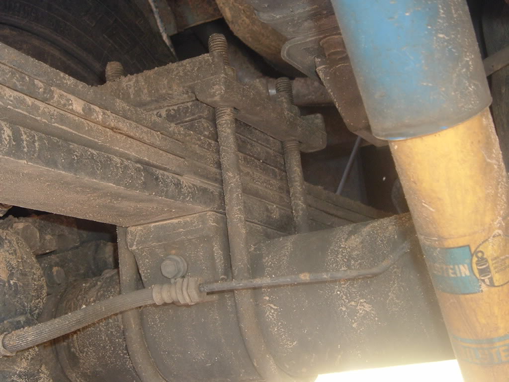

If you look on the rear axle leafs you will see the spacers I'm talking about, its under the leaf pack. I jacked the truck up in the back (at the differential) then put jack stands under the frame to support the weight. Then I started on one side, pulled the u bolts and unbolted the shocks and dropped the axle enough to get the spacers loose. When you get the spacers out put them on top (the spacers have a weird bushing sticking out to keep it center, if I remember correctly you have to either take them out or flip them also), then you put everything back together. I did one side then the other. Tooks a few hours cause I cleaned alot up.
Pics are with the spacers on top, bringing the ride heighth down about an inch.
