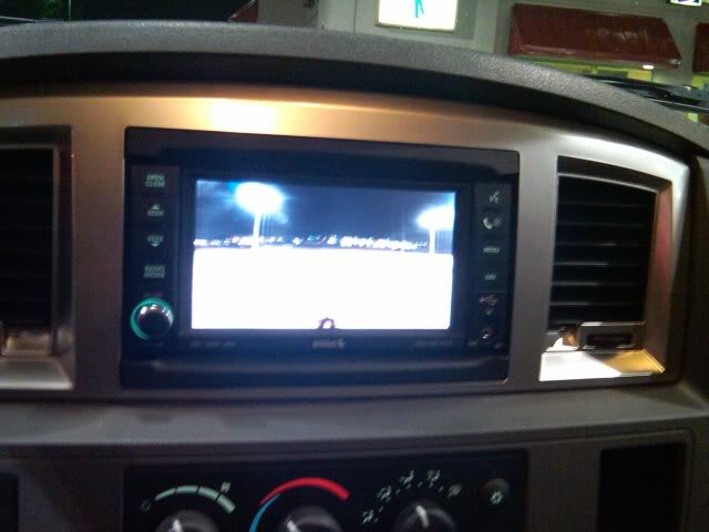

my test screen, if only i could find a place to mount in cab!

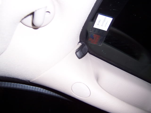

here is mic i installed for the uconnect feature

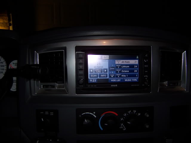

Looks great. Were did you get the double din install kit? I have been looking every were and can only find single din install kits for the deck.

the double din kit is actually the bezel i bought from a factory gps unit, it came with an aftermarket trim kit that i had to cut down to fit, nobody makes a kit that will adapt the mygig to our trucks with the gps bezel, there is some joker on ebay that wants 75 bucks for two pieces of plastic that he makes, but its just principle to me, so i cut it up, sanded and painted to fit, it looks okay but i may change it later. there is a thread on this site about a mygig install by pooter i think and he did a great job with his.
