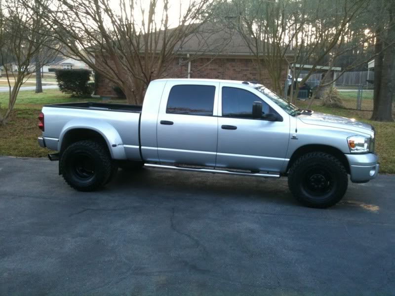

37x12.5x17 on a stock suspension truck. 2" spacer out back.

thats an awsome truck! have a couple questions for you, do the front tires rub at all and if they do do you think a two in leveling kit would help? what kind of spacers did you get and where from and are those the stock rims?thanks for the pictures thats a sweet truck
Old Jul 14, 2011 | 08:01 PM
SpeedyWS6's Avatar
Posts: 492
From: Longview, Tx
Thanks...
The fronts rubbed the inner fender slightly in some turns, but trimming the lower rear portion cleared that up. The rear inners required the corners that stick out being trimmed. Those are the stock wheels. It's hard to say about the leveling kit. The single wheel guys get away with it. I can't decide if I want a leveling kit or not as my trailers squat the truck pretty good. I got the spacers off eBay. They have been good so far.

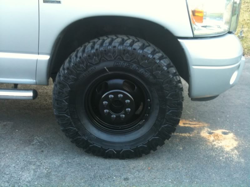

sounds good one other thing those cooper stt tires your running are they load rating e or d and on your stock rims did u just take the rim inserts out and paint the rim or what did u do there
Old Jul 15, 2011 | 07:11 AM
SpeedyWS6's Avatar
Posts: 492
From: Longview, Tx
They are d but the actual load rating is around 2500lbs each if I remember right. You won't find an e in a 37.
I just pulled off the simulators and put some gloss black on the stock wheels.
EDIT: The tires are rated at 3525 lbs each. Goodyear makes a 37 that is a d rated at over 4000 per tire.
