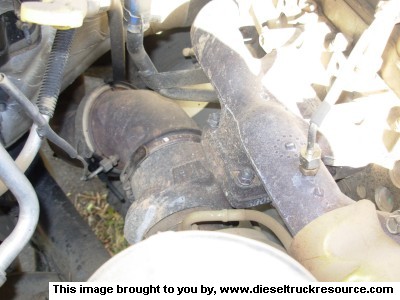

Here is both of my pyro taps
Shane

Take a look in my gallery.. there are a few pictures of my pyro and boost install... If you install it on the down portion of the exhaust manifold (as i did) pull the plastic inner fender well and it give you a ton of room to work in there right through the wheel well..
