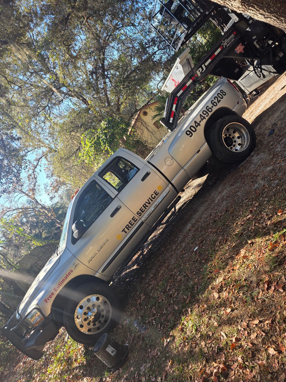

What gear change needed for 255/70 22.5s! I was told 4.56
