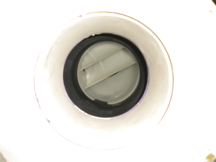

On mine I simply removed the inner baffle tube and re-cemented the MPC together...looks factory. And yes, I too consider the turning vanes important(as an A/C technician, i do know the importance of keeping the incoming airflow smooth.)

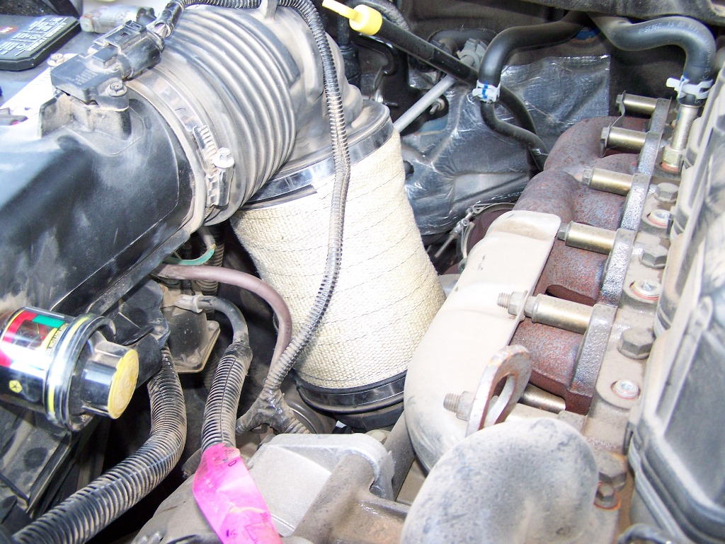

Header wrap you say... You just reminded me that I've had a 50'x2" roll of DEI header wrap stuffed in a box in the garage for the last 4 years without a good home... Think that would make for decent insurance? Or would it retain heat after a while?
I saw a post and thought I would try the same. I popped off the cap (cracking sound and all) and thought there would be more of a lip that I could re-cement. What type of cement should I use? I'd be more inclined to carry the gutted stocker around as a spare for a while. But I sure wouldn't want it leaking and sucking any dirt in

I think header wrap would insulate well considering it would be pvc pipe. Now on a piece of aluminum it may aid in retaining heat.

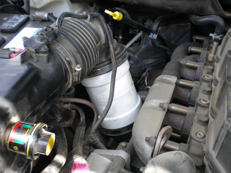

Does this look any better?

1) ABS cement.
2) There'd be no point using turning vanes ahead of the cross baffle.

?I have my PVC intake with 1/4" of my manifold with NO problems at all. About a month and a half now, and I watch it close. Not even began to melt.

Looks professional to me

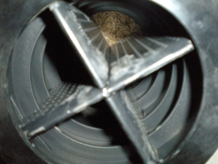

As for the baffle...no need to remove any of the end caps. I used a hacksaw blade and cut 2 of the baffles from end to end with the blade through the tube, then removed the rest of the baffles and cleaned all shaving out. No gluing required.
I do like the thought of straight pipe with 0 restrictions however...and yes I agree to leave the directional vans in the bottom section in to aid in smoother airflow.
