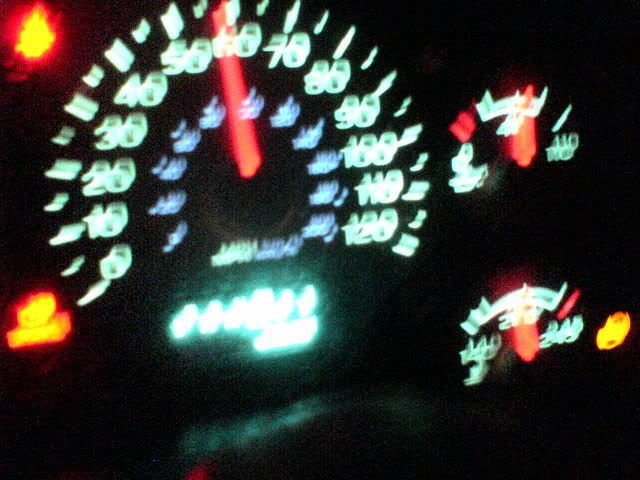

Here is a picture of the abs and parking brake lights...
Sorry for the poor quality it was my picture phone.

I just worked on it for a bit. I did the trick with the battery cables. It alone fixed part of the problem. The brake light was flashing like is should be.
A guy on the phone told me to try the back up 50ft, pull foward, shut truck off thing. I did that two times and about gave up but on the third time the lights DIDN'T come on.
The truck was still in limp mode. I took it out on my dirt road and it literally wouldn't spin the tires in gravel. I turned around and came back home. I debated on trying to load the bully dog. I had no clue if it would screw something up worse. I loaded it and everything is GOOD now.
