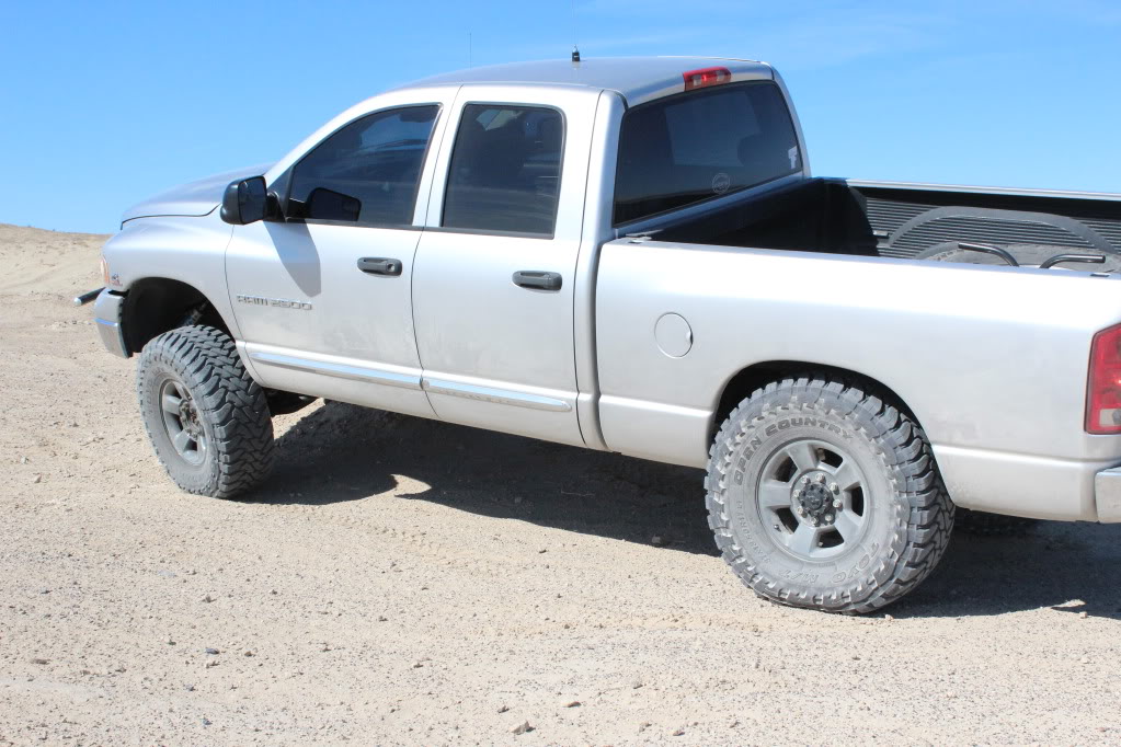

37" Toyo's on stock wheels aired down to about 25 lbs.
Yes Sir...that is the look!

Are they aired down by your preference or due to your adventures that day?
I ask because they mentioned with the 35X12.50 that they typically run 45 in front and 40 in rear.
Old Apr 6, 2012 | 10:48 AM
sloride's Avatar
Joined: Oct 2008
Posts: 174
Aired down for off road. On the streets I run them 42F/32R. They feel good there and wear evenly. I kick the pressure up when I tow.
