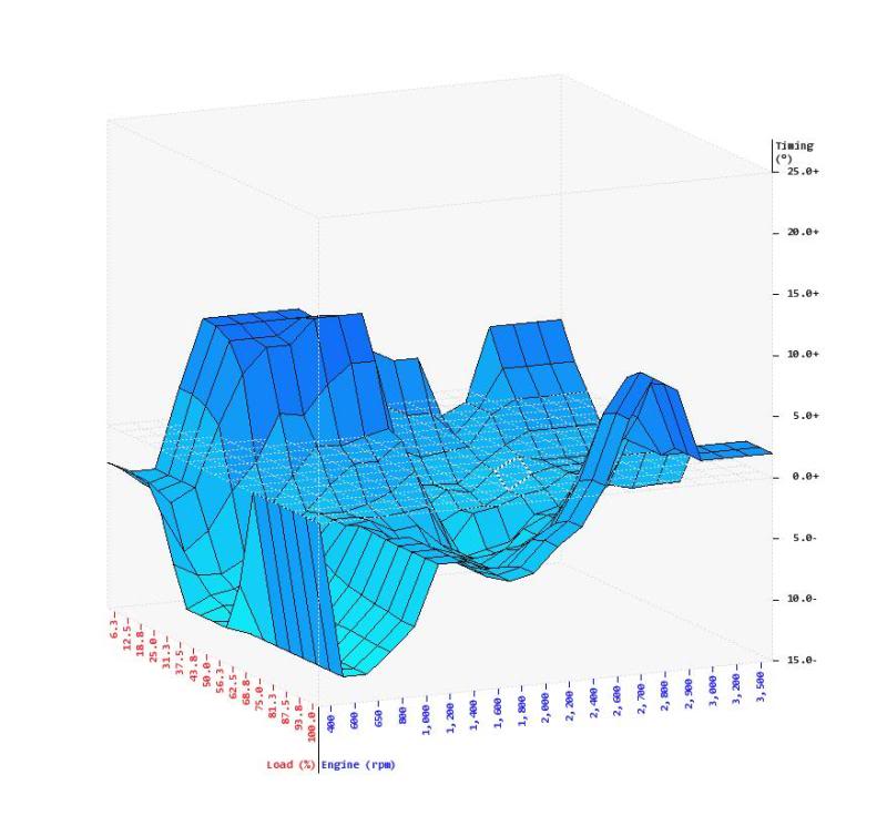

OEM timing.

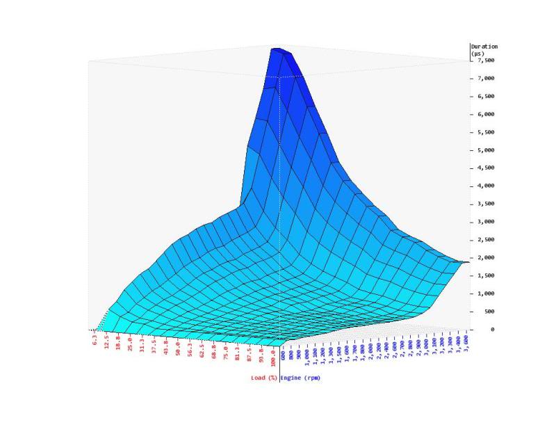

OEM duration

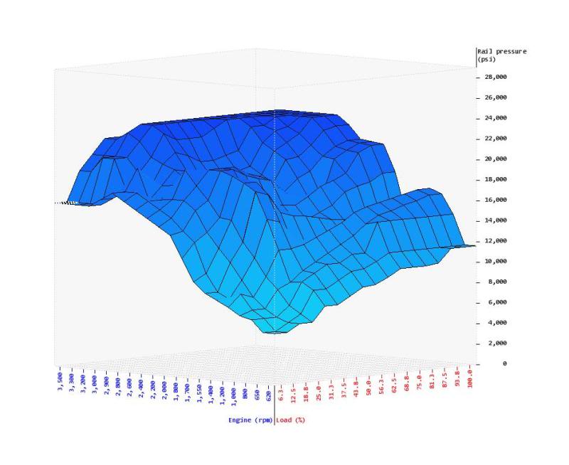

OEM rail pressure (not adjustable on the SJR)

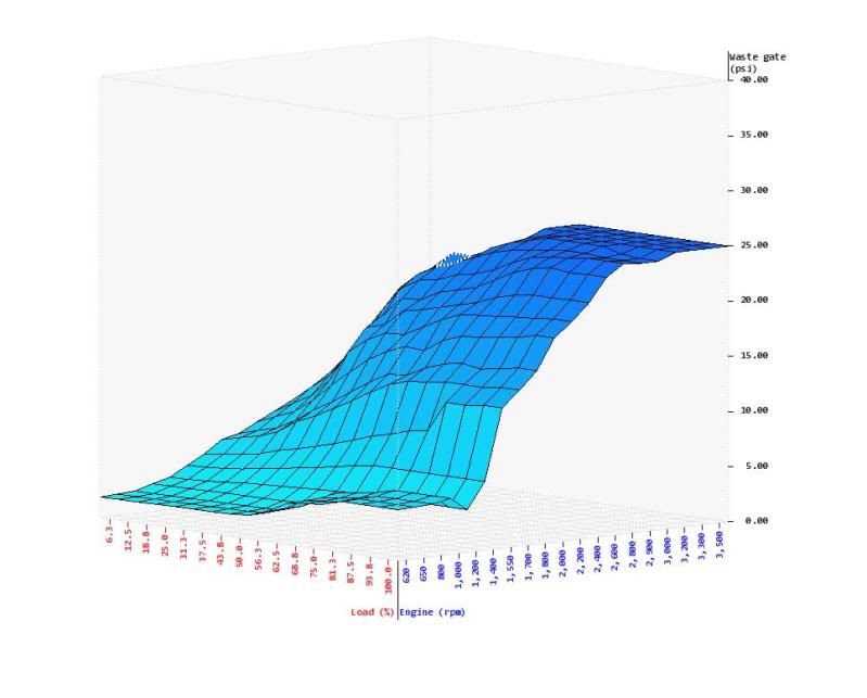

OEM wastegate

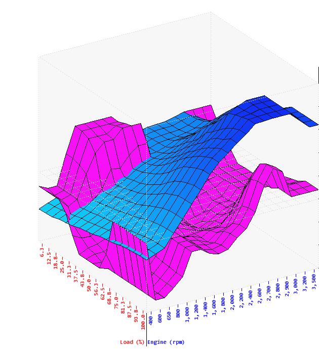

One of my favorite features of UDC is the ability to compare and overlay two tunes.
