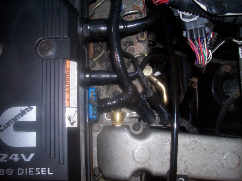

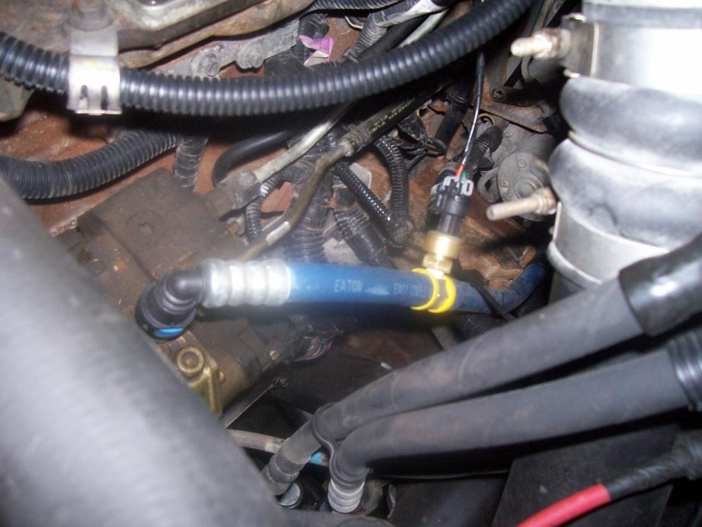

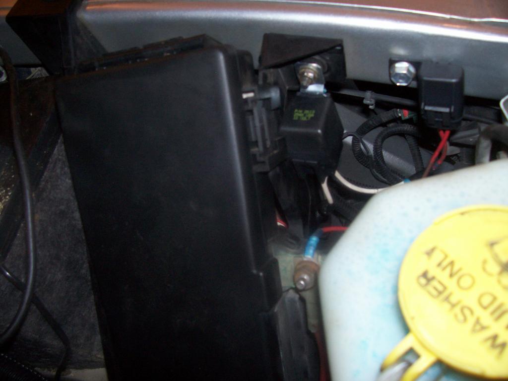

These ones are of the gaguge senders installed, top view of the -8 to the CP3. and the relay and fuse installed for the Raptor pump next to the TIPM. I found it odd that the Raptor didnt come with a relay, and moreso that the spade you were supposed to"plug" into the fuse box was for standard blade fuses, not Mini's like this era Ram has. I added a relay using power from the TIPM feed terminal, using the TIPM only to switch the relay with the key on. I didnt want the fuel pump load on the TIPM itself, they are unreliable enough as it is. A 20 dollar relay kit and 20 minutes and were golden, using only a 10 amp fuse and a draw of just 5 amps the Raptor runs.

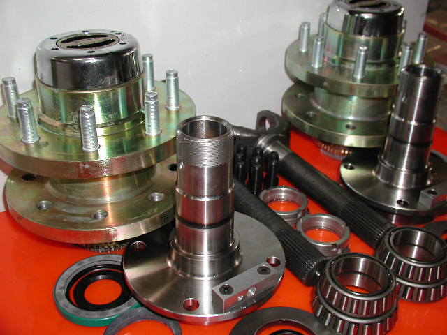

I was just reading through the instalation instructions for the EMS and Dynatrac free spin kits. For a single wheel application the kits would be a wash in my opinion, other than the obvious cost difference. For a dually the EMS kit is hands down a better choice. Heres a picture of the EMS DRW kit and a small clip of the instructions for the Dynatrac kit.
3. This kit MAY NOT be compatible with Dual Rear Wheel (DRW) trucks.
Trucks equipped with the DRW wheels WILL require a special DRW adapter. These can be purchased through Arrowcraft. (248)-280-0210 Ask for part number AA4DDT as these parts have been made to work specifically with Dynatrac’s Free-Spin kit.
Test fit the DRW front wheel adapter on the new hubs BEFORE installing the kit. If the adapter does not fit STOP!! DO NOT weaken the adapter by removing material from the inside! DO NOT remove material from the new Dynatrac wheel hub. At this point you may return the kit to the place of purchase for a full refund. Contact Dynatrac if you need assistance.
WARNING: Removing too much material from the inside of the Stock DRW front wheel adapter may weaken it, and cause the wheel to separate from the vehicle without warning. This may cause property damage, injury or even the death to your vehicle’s occupants and those in vehicles around you. You may choose to stop now and return this kit for a full refund. Or you may replace the stock adapter with a suitable aftermarket part. Contact Dynatrac if you need assistance.
By the time the adaptors are purchased and the shipping is paid in the parts your going to be 800+ more for the Dynatrac kit.
That would be very hard to justify the money for the job at that point.
Notice on the EMS kit the adaptor is a 1 piece machined assembly and the brake rotor bolts to the back. Very simple and effective. No extra parts and 8 less bolts holding the wheel on.....
