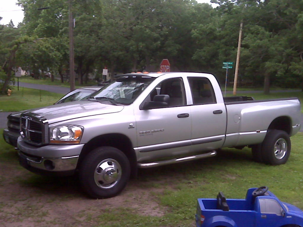

Heres a starter pic for my new tank!
-Ryan

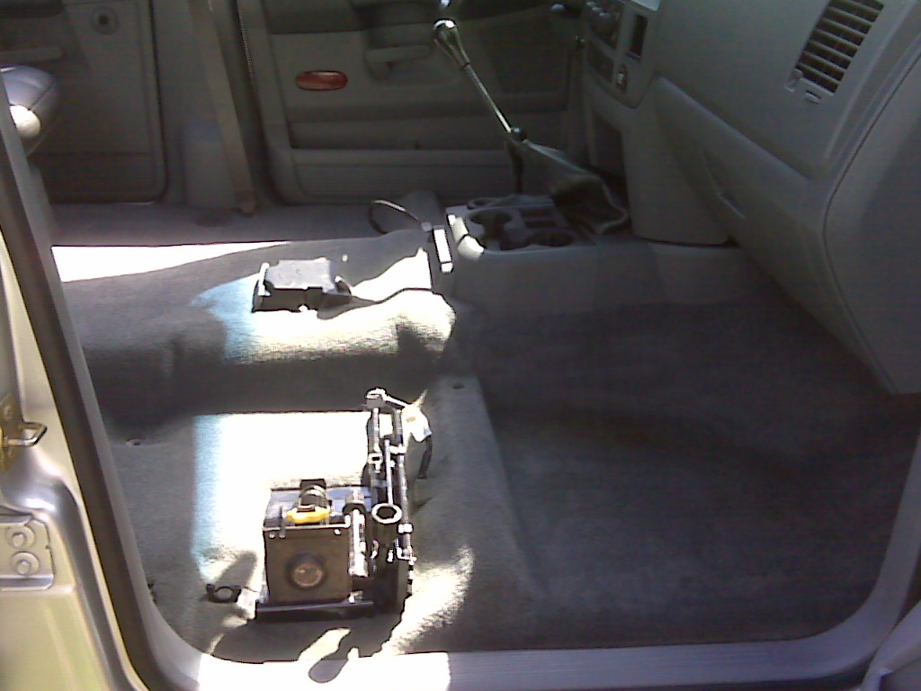

Heres a few pictures of the fuel system install, clean shampooed carpet and new seats. Ill add some more later today or early tomorrow.

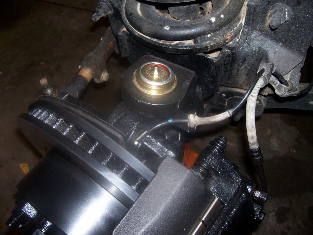

Well, the trucks been laid up for over a week now getting some much needed attention. On the agenda this time is some needed things and some wanted things. Rear brakes were on the wear indicators and the ball joints were loose. Ive been trying to get to the bottom of the "rear end bounce" over bumps and on accell. as well, it felt to me like spring wrap and junk shocks. I clamped the front of the rear leaves together with vise grips and went for a drive, it was notablly better. So now I had a game plan. I work for Kremer Spring, we do leaf fabrication, modification and repair there (along with about everything else) So I planned for the following.
-Front and rear Bendix Fleet Metlock pads and premium rotors.
-Upper and lower ball joints and wheel joints while the hubs are out.
-Fat Bob's 2" leveling kit with 4 Bilstein 5100's.
-Remove rear leaf springs and refit leaves, and strap all fronts together.
-Thermostat and coolant flush/Belt and flush brakes and go to Dot 4.
I pulled the front suspension apart and got to work. I found newer front wheel joints installed already, It looks like they used an unorthidox method to install them, there was up and down play doth directions indicating the yokes may be spread. I made a call to our local drivetrain shop and they set me up with new complete OE shafts for both sides for 300/pair. (inners/joints/outers) already assembled. I bead blasted the calipers, brackets and spindles as well as all hardware and painted all parts semi gloss black. Pressed in the new ball joints and began to assemble again. I noticed the front unit bearings have a squeek to them like a wear indicator on a brake pad. So I needed to deliberate.......
The unit bearings are too expensive and they dont hold up as well as they should for the money, and im annoyed that these trucks roll the entine front driveline all the time. That just sounds like a reason to wear out more expensive parts....
So I spent some time looking at free spin kits and what they come with and require. I know the old addage about you get what you pay for. I looked at the Dynatrac, EMS and one other. After doing some reading and looking carfully at the kit contents I chose the EMS kit. It looks like for the dually trucks theres no comparison, and the price was easier to swallow. So its ordered, I expect it on on Oct. 13th.
So currently hung up on the front end waiting for parts
The Bilsteins and Fat Bob kit should be here around Oct. 13th as well. So I guess I have extra time to "polish" and make things look new again.
I pulled the leaves and brought them to work. Our spring guys did their magic and they went back in the trunk the same day for the ride home. I got the RH rear installed tonight, but I ran out of beer, so the other side is to follow
I pulled the rear axles out and pulled the rear hubs/rotors. hubs have been bead blasted as well as the calipers/brackets and all hardware. Today I installed the new rear rotor and axle seal on the RH rear and reassembled. Looks shiney new.
Ill likely finish assembling the LH rear brake tomorrow and get the LH leaf back in as well as get the rear shocks pulled waiting for the Bilsteins.
I didnt take alot of "during" pics. Just some before and afters to see the progress and final product.
