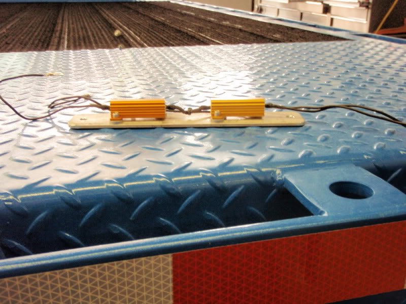

What he said.. How many of what kind are you putting on? I had enough markers and tails I did not need the ones for the running lights only the TS ones (RL 650).. keep in mind they get hot so place accordingly.. I mounted mine to some Al strap and then spaced it out with some washers for heat dissipation..
