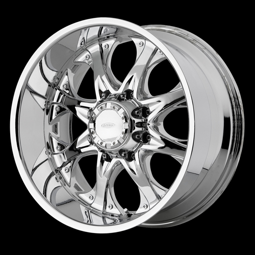

Ordering the wheels below in 20x9. They offer the following backspacing and offset: +25mm 5.98" and +10mm 5.39". Which would be best to go with Cooper Zeon 305/55/20? By the way, my truck is 2WD and I know I'll need a leveling kit. Also, I don't mind a little of tire extending past the fenders...but just a little for a meaty look. Thanks for the advice, it's very much appreciated.

I'd go with the 5.39" with that wide of tire, the 5.98" would make you rub on the control arms.

Lets lay some numbers out so you can make an educated decision...
1) 265/70 R17 = 31.6x10.4x17 (stock tire size)
2) 305/55 R20 = 33.2x12x20 (tires are 1.6" taller & 1.6" wider)
3) A +25mm offset = 7mm (0.28") inner clearance & will stick out 33mm (1.28")
4) A +10mm offset = 22mm (0.86") inner clearance & will stick out 48mm (1.89")
The 25mm offset will rub the control arms on my truck with those tires. The 10mm offset will probably not rub anything on my truck with those tires but I have a 4x4 which makes a difference, your 2 wheel drive sits alot lower. Your best bet would be to level your truck then find a store that will let you test mount different size tires on rims with different offsets.

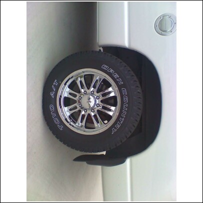

Here's a pic of a 20x8.5" wheel w/ +20mm and a 305/60/20 Toyo tire.

Will do...........did you see my pic, still sticks out far enough to make a mess when I hit a puddle and that's +20mm.

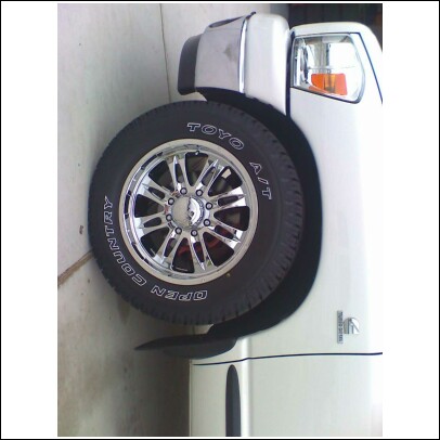

I'm here to tell you a 275/65/20 is the biggest 20" tire a 2wd can handle stock.
