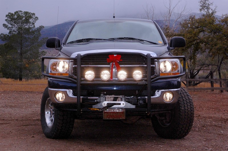

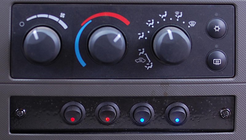

New off road lights and switch panel installed today:

Sweet set up, but is that one switch for each light?

One switch for the two outside lights (aimed a bit outward), one swtich for the inside lights aimed straight ahead. Two spares for future use. (porbably one for back up lights).

Very nice job with the switch panel, looks like part of the truck. I have a dislike for random cheap toggles sticking out of the dash or hanging underneath, so I tend to make OEM-looking panels like yours. I'll have to put up a pic of mine some day.

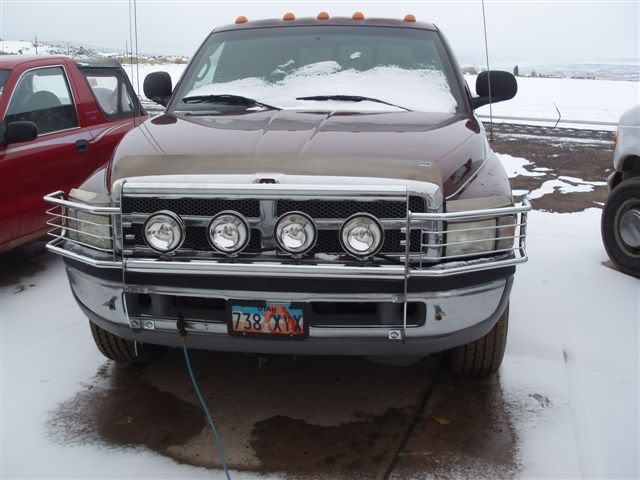

here's mine, wired to the high beam with a switch to turn them off in case of the law stopping me and checking..... DOT reg's limit bulbs to 55 watts.....mine are 130 watts each...
Geeze, that's a lot of light! Mine are all 55W and it makes a world of difference compared to only stock lights.. Mine are a more spread out pattern also, lighting the sides of the road/trails.
I hope you are running them all through seperate relays and using big wire. Total for those is lights is around 40 amps!
