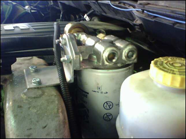

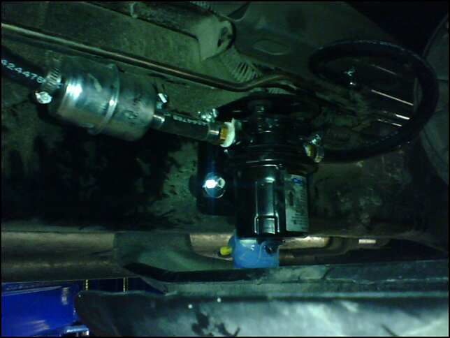

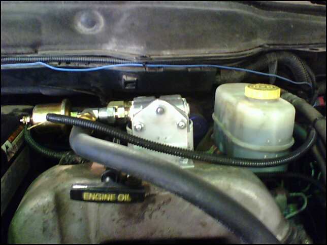

Yeah, yeah , yeah.....pics will be up tomorrow night! Digital camera was DOA! Anyhow, I put on a BD lift pump and a custom 2 mic filter. Mounted the filter on the back side of the intake horn......pretty nice fit I might add! Put the lift pump back on the frame rail, just in front of the tank above the skid plate. Well protected I think......worried about the snow/ice build up though !? Ran 1/2 " line from the factory filter to the 2 mic filter, and also from the 2 mic to the CP3. Hard to tell if any improvement on the SOP dyno, and fuel pressure sending unit is on it's way from quad ( my original is on the blink!) So far , with a questionable sender, the pressure is up to about 9 psi at idle and 3-4 @ WOT. Really was hoping for more......? Maybe the new sender will prove me wrong though! Let's hope so! The following is a list of parts ( I can get numbers if you want ) with approximate costs. ( Man....hope the wife isn't reading this after the 1129$ tires, and 600$ ball joints and tie rods! )
Lift pump kit BD Diesel - $300 shipped.
WIX Filter head, 2 mic filter, strainer filter before pump - NAPA $75
Big line kit - Vulcan Performance- $36 shipped
1/2" Fuel line - Cummins Dealer - 6' - $12
More fittings from NAPA - $30
All toll , it took about 4 hours to put on and that included fabbing up the intake filter mount , wiring up a relay for the pump ( BD's kit runs the pump right off the factory wiring......wanted heavier guage wiring myself!), checking for leaks and of course , a few beverages! Not too many though, needed to keep my head straight! That and opening day for deer season is in ohhhhhhh about 4 hours! Short night tonight!

Here's a few pics......cell phone will have to do........digital camera is still DOA! The bluish glob on the bottom of the pump is silicone sealant. Just trying to give the connections a fighting chance!
Attached Thumbnails New lift pump and 2 mic filter !-fuelpump.jpg   New lift pump and 2 mic filter !-fuelpump1.jpg   New lift pump and 2 mic filter !-fuelpump2.jpg
