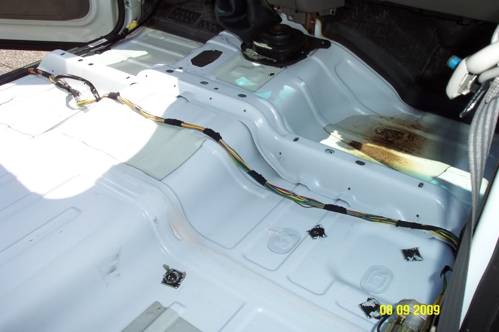

Heres a shot of the stock floor

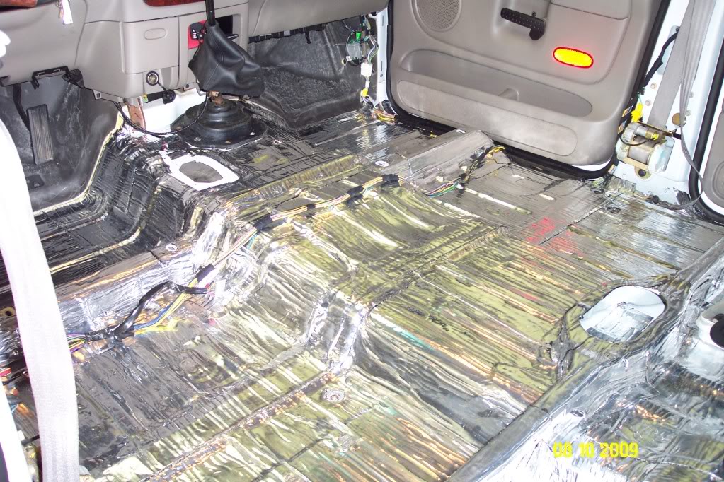

Floor with a coat of Rammat BXT

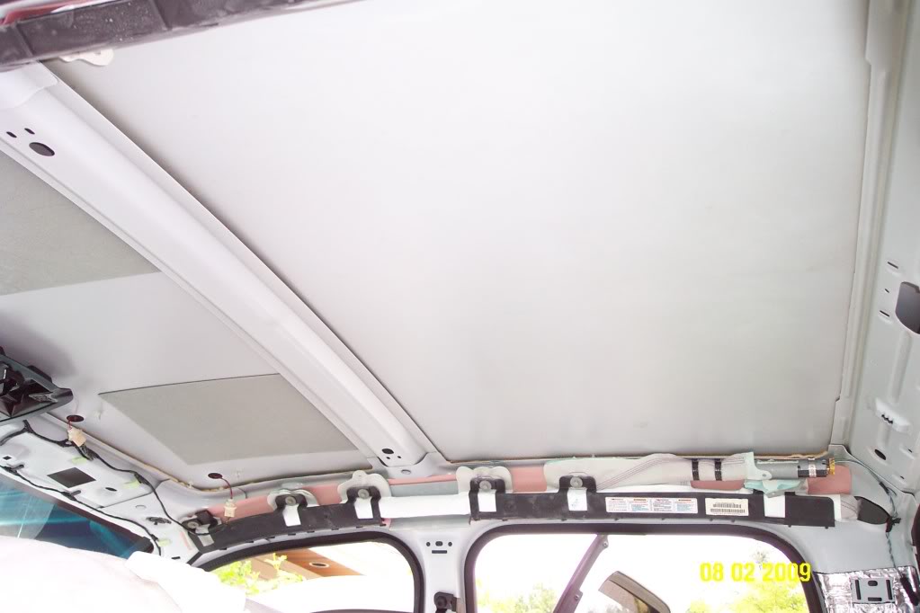

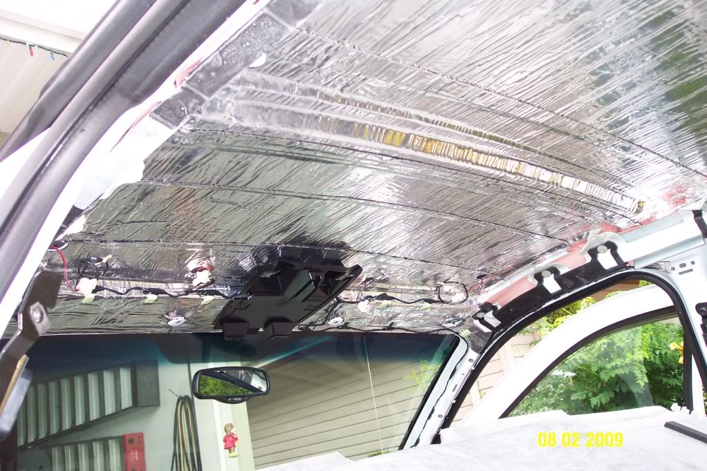

Factory sound deadning on the roof LOL
After BXT treatment

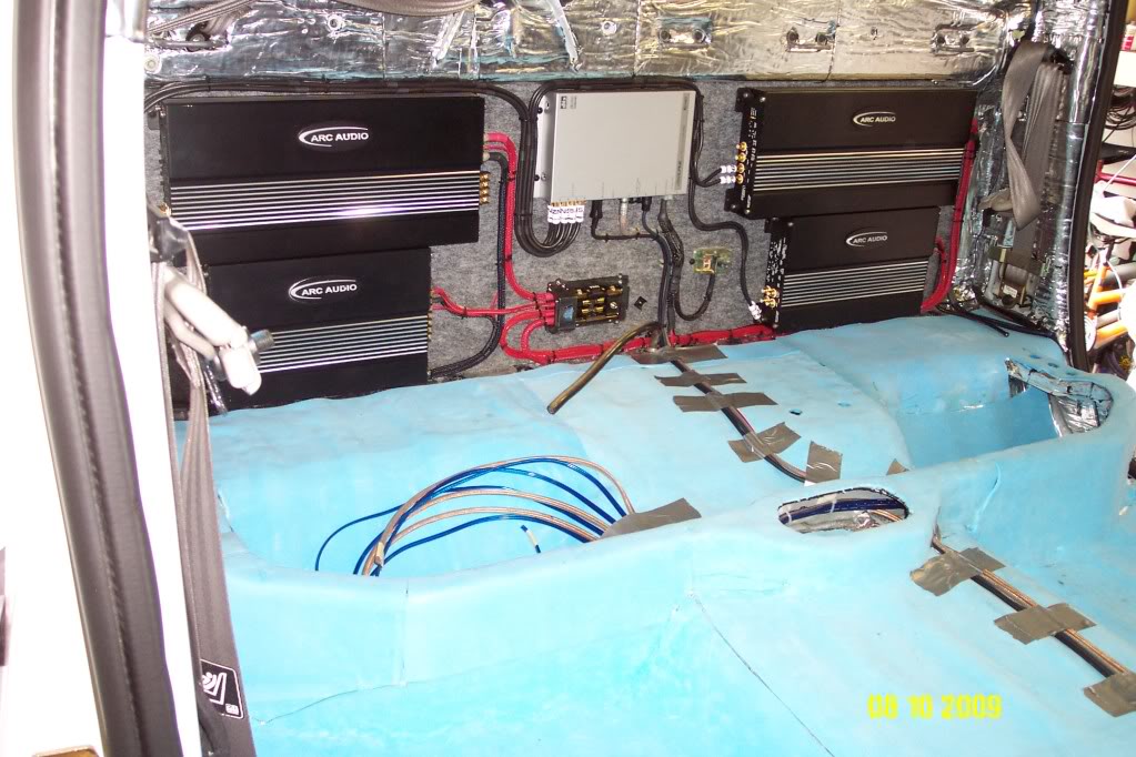

Amp Rack installed and a layer or 2 of 1/8 Neoprene over the BXT

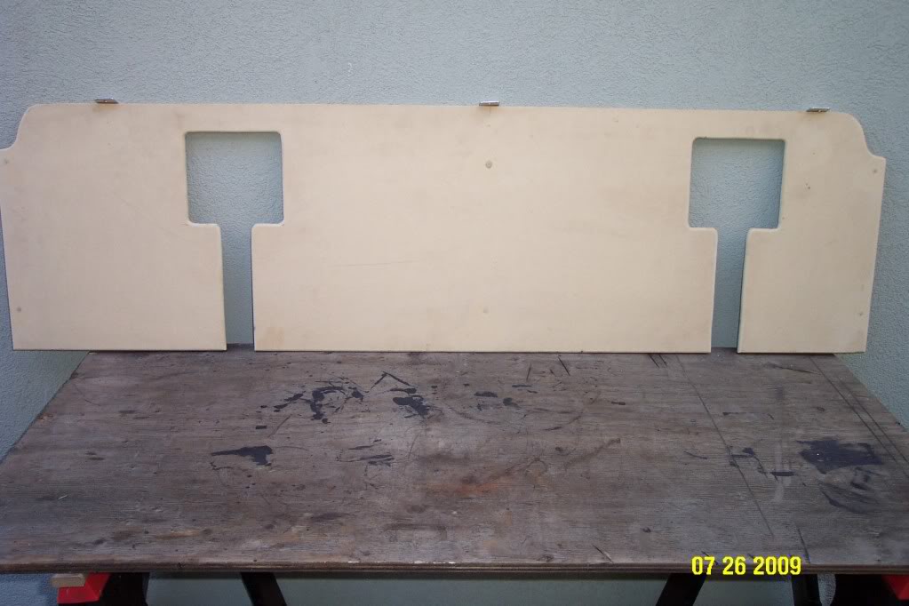

The amps are mounted to a piece of 3/4" MDF that I wrapped in carpet.

Most shops use a barrier foam (ensolite) to help stop reflections but this Neoprene looks like it will do the same job and since I had it already, I figured I would give it a try? The roof and floor already have a soft material covering so it probably won't do anything in those areas but I was on a roll LOL

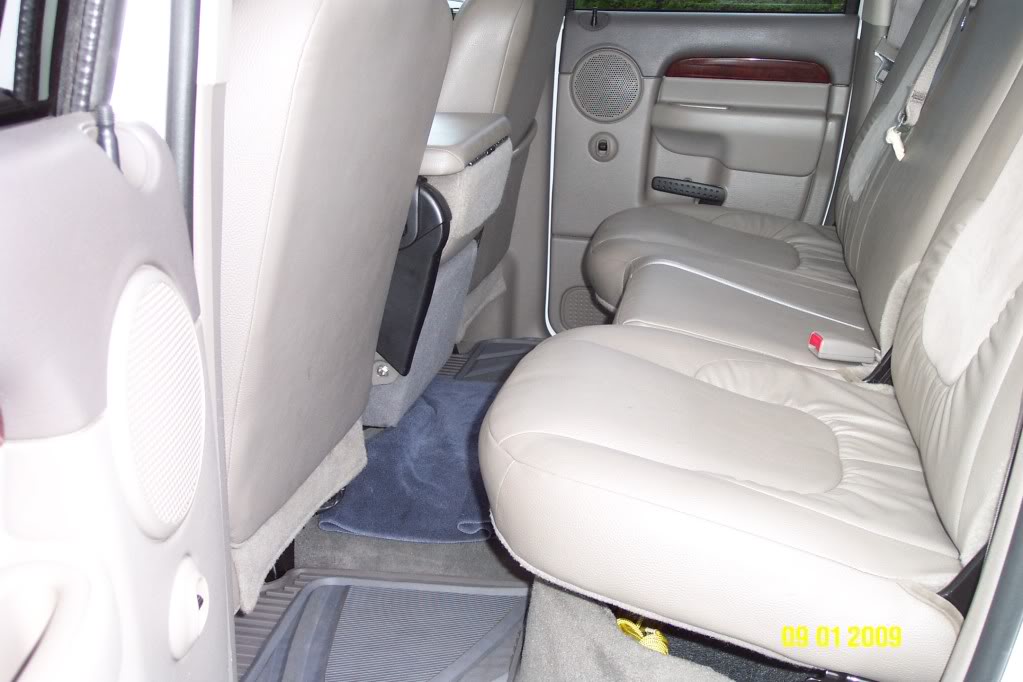

Have never had my seats out, is there enough room behind the back seat for air to cool all those amps?

There is more room than the second gens behind the seat and I never had any trouble with them over the years....?

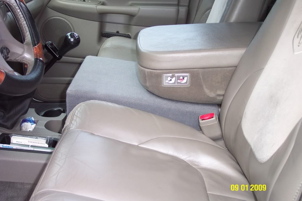

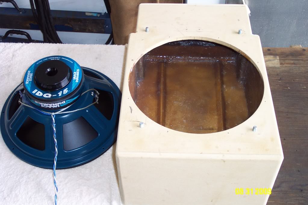

Well the sub enclosure is finished but when I have the time I am going to pull it out and recover it with the right colour vinyl and carpet (this grey was all I had and I figured it was closer than it is ) but time doesn't allow for it now.
Heres the enclosure and sub
I used 1/2" mdf and put 3 layers of FG mat on the inside

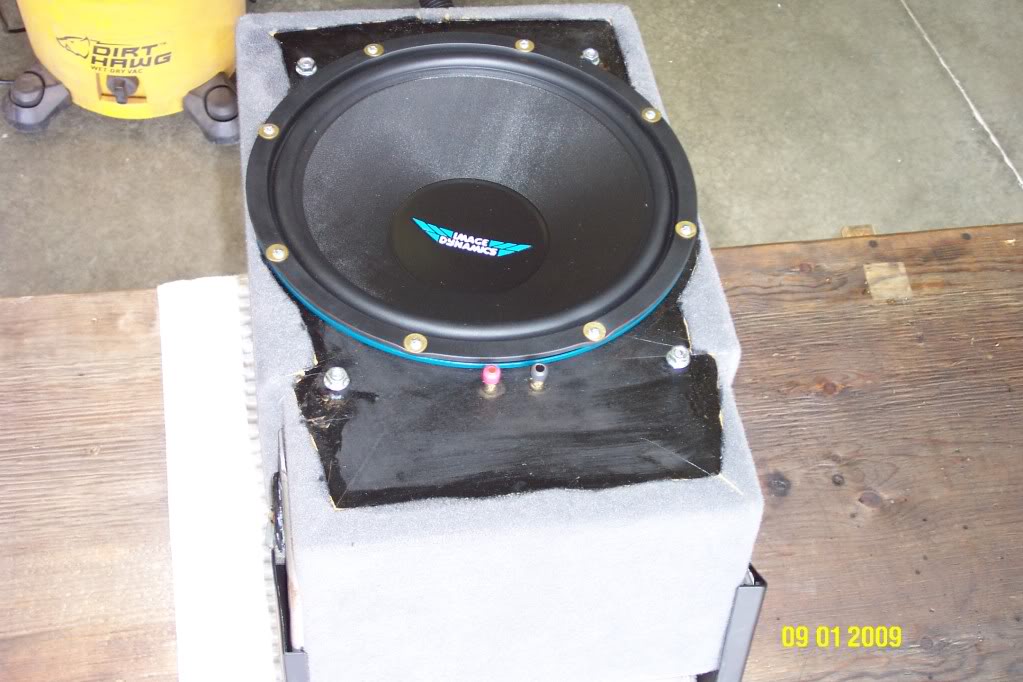

Carpeted with arm rest and sub loaded
Installed, don't laugh at the colour
